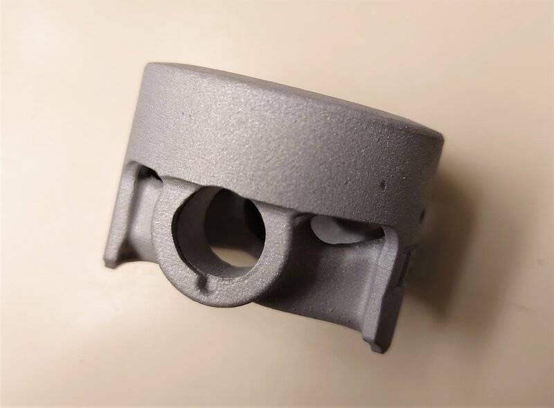

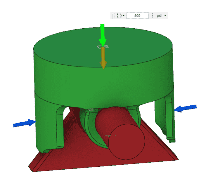

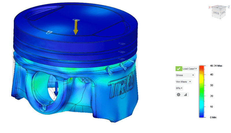

A 3D-printed piston made from AlSi10mg is being tested for its potential to reduce mass and increase engine performance in a 1970s Honda XR75. The new piston weighs approximately 50 grams compared to the original 79 grams, which could theoretically enhance responsiveness and allow for a higher redline due to decreased inertia. However, concerns about engine smoothness arise, as the crank counterweights may not be balanced for the lighter piston. While reduced mass could lead to faster acceleration, it does not inherently increase power output, as the combustion force remains constant. Ultimately, the trade-offs of lighter components must be carefully considered to avoid negative impacts on engine dynamics.
novaguy

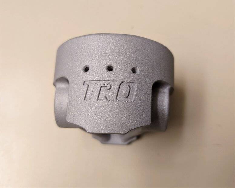

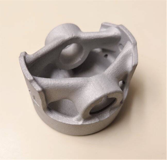

TL;DR Summary
Less work done to reciprocate the piston. Where does that work go?

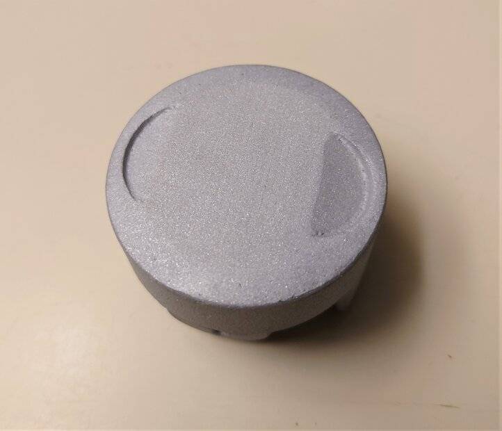

This is a piston I had DMLS printed from AlSi10mg - the geometry is derived from generative design using some basic inputs and a starting shape. It's really just an experiment whether a consumer grade design and print can be bolted in and work for a time.
After machining, it is predicted to weigh ~50 grams vs the OEM 79 grams (1970's Honda XR75). The question is, will this lighter piston result in a small power increase as less work done by reciprocating the piston? Theoretically, the rate at which work is done will be increased?
With the reduced mass, the redline could be increased slightly due to less inertia load, but besides that? Of course, the engine should be more responsive (quicker to spin up) and with a much smaller skirt area, less friction too.

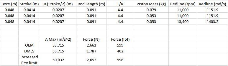

By my calculations, at maximum piston acceleration (~TDC) @ 11,000 RPM, the inertia forces on the piston are about 33% less.

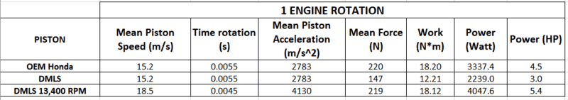

Ignoring power increase due to higher RPM capability, just purely the reduced work on the piston; Here's my line of thinking and correct me if I'm wrong:
F = ma
The force from combustion pressure is not changing. The reduced piston mass will increase the acceleration of the piston.
a = dv/dt
The increased acceleration means it will hit higher velocities along the stroke.
P = fv
If the combustion force remains the same and the piston velocity increases, Power should also increase?

When at a constant RPM, it is true that the piston will accelerate (from the end to the middle of the cylinder) but it will also decelerate equally (from the middle of the cylinder to the end). But the average acceleration will be zero - otherwise, the RPM wouldn't be constant.
The acceleration of the piston is defined by the RPM and the crank-rod geometry. The forces and masses are irrelevant.
Having a smaller mass will not increase power; the power input is defined by the combustion force and the rate at which it occurs (i.e. the RPM of the engine). The force acting on the piston being the same, the RPM being the same, thus the power is also the same. The only thing a smaller mass will do is give a higher acceleration/deceleration if the resistance force (for example, the aerodynamic drag acting on a vehicle) does not balance out the forces acting on the pistons.
Even though it requires energy to accelerate a mass, it is given back when it decelerates. So the net energy required by acceleration is usually zero. Inertia is related to kinetic energy which can be used as a storage mechanism, like potential energy or spring potential energy.

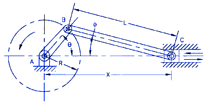

That being said, the instantaneous piston acceleration of a slider-crank mechanism is defined by simple geometry. From this link:
Note that this is true even if there is nothing pushing on the piston or driving the crank. How is that possible? It is like a pendulum: When the crank pushes on the piston it wants to slow down - thus losing energy - but when the piston pushes on the crank during the other half of the revolution it regains it all. All it needs is the initial energy input to start the motion, like when you lift a pendulum to initiate the swinging motion.

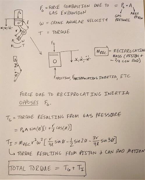

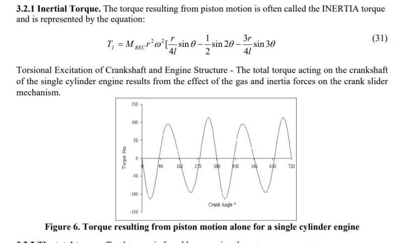

Can someone tell me if this is wrong mathematically?
The equivalent mass of the reciprocating components MREC (piston and some proportion of the connecting rod) will be reduced by a small amount, due to the piston mass being 33% less.
FI=MREC*AREC
The Inertial Force, FI will DECREASE with a lighter piston.
Because the Inertial force FI OPPOSES the force due to combustion FG, there is a larger positive total force in the direction of FG. The total downwards force propelling the piston and crankshaft has less force resisting it. More of the combustion pressure is available to drive the crank instead of accelerating a heavier piston. This is not much different than increase power output due to thinner, low tension, coated piston rings.
With more force reaching the crank, this in turn will then create increased total torque by some small amount.

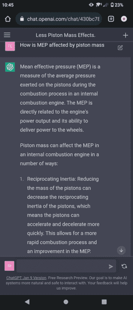

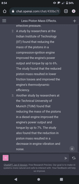

Could this be seen as an increase in efficiency? Work*Efficiency = WorkOUTPUT
If you ever find some mathematical equations that seem to demonstrate there will be an increase in efficiency while modifying the mass, then your equations are wrong.
Oh yes, it is much different. The thinner, low-tension, coated piston rings will create less friction. Friction is energy going away in heat. It cannot be recovered. Inertia is energy stored while gaining speed. When it will slow down, the energy will get back into the system; 100% of it, with no losses whatsoever.
Have you forgotten that the main bearing forces will increase due to the unbalance? Main bearing friction losses will therefore increase. The unbalanced forces will radiate vibration energy from the main bearings, through the engine mounts, to the vehicle.
When it comes to energy losses and efficiency, where you model the discrete piston mass, you must also model the discrete counterbalance mass, and the out of balance forces. If you do not do that, you are cherry-picking the gains while ignoring the losses, resulting in a false claim.

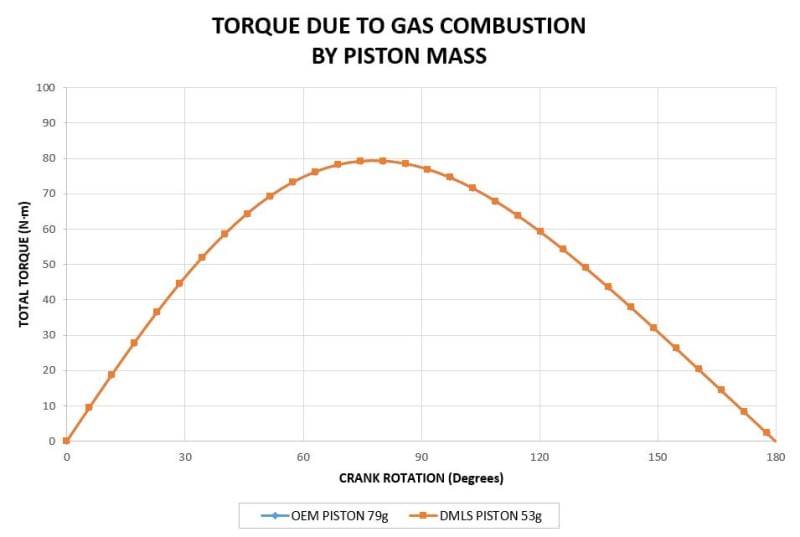

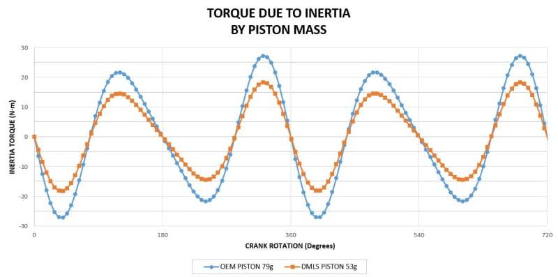

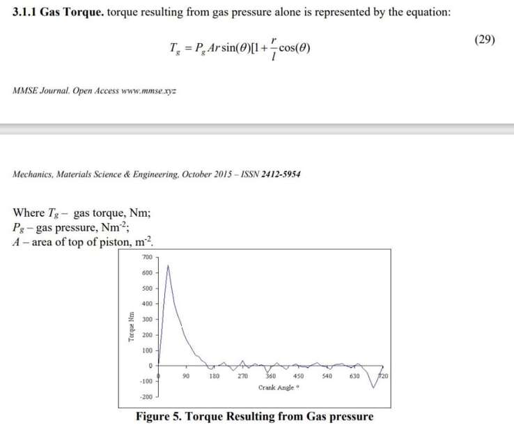

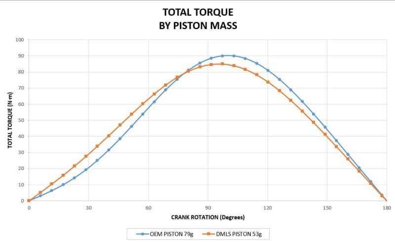

I went ahead and plotted these using the actual engine geometry and an assumed gas pressure of 300 psi.
Torque due to reciprocating inertia (piston and con-rod):
Keep in mind, a realistic plot of combustion would be phase shifted and have a sharper peak. However, this does show the contribution of lower inertia on the RATE that the torque is produced.

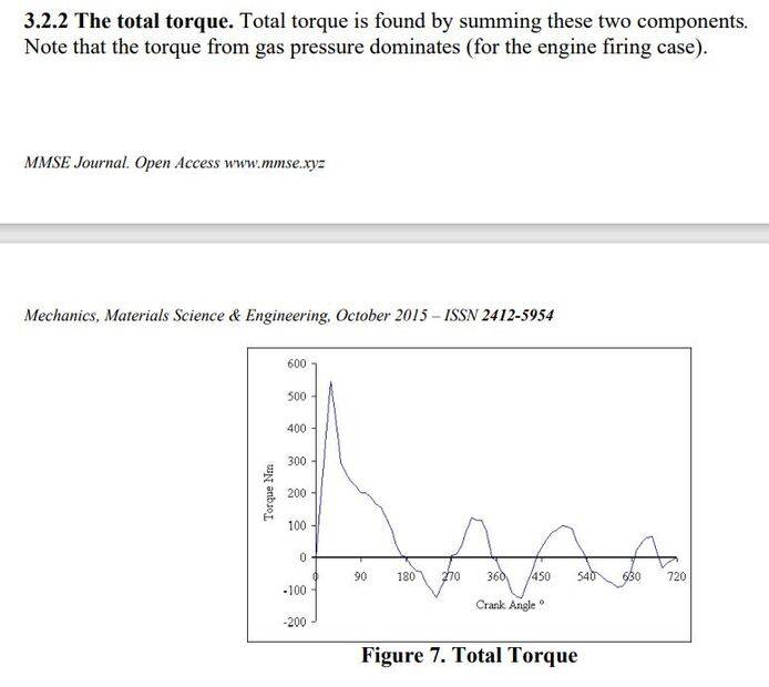

Total Torque = Inertia Torque + Torque Due to Combustion (the gas pressure is equal for both pistons obviously):
"Given the exact same combustion chamber conditions (this is a huge, glaring condition which is highly unlikely in the real world) making the rotating assembly lighter yields a direct increase in shaft power. This gain, in the real world, is going to be very small - small enough that depending on what specific dyno technology is in use, it's very likely to be impossible to measure consistently- but it's there.
For a particular combustion chamber configuration operating at 100% load, the amount of energy available due to each individual combustion event is fixed. If you start at idle RPM and accelerate under any load, the piston velocity on the compression and expansion strokes are going to be different; the energy to create that difference in velocity comes directly from the fuel being consumed. If the piston is lighter, creating that velocity difference takes less fuel.
If you're operating at 100% load, you are still getting the exact same amount of power extracted from each combustion event - but less of that power is being consumed by accelerating rotating components, and more of it is making it to the output shaft and into the load being accelerated.
The difference might become large enough to become measurable if you were to spend big dollars to lighten every moving component; you'd create other problems (ie, NVH) along the way."

Can we agree that lower piston mass will reduce the torque due to inertia?
Can we also agree that the torque resulting from gas expansion is equal for each engine (one with a lighter piston, the other stock)?
And that the total torque generated (not including resistive torques for simplicity) is the sum of these torques?
It seems that the effect of lower reciprocating mass is an increase in the rate of torque. Can anyone confirm or refute this mathematically? Not with conjecture
  • #31
this journal or whatever you're quoting from looks interesting but honestly the .xyz in the address makes me leery of going there.
  • #32
Nothing revolutionary but gave some nice equations of motion to plug into with my engine geometry/mass.
Attached is a PDF copy of the paper:
Hailemariam Nigus. Kinematics and Load Formulation of Engine Crank Mechanism. Mechanics, Materials Science & Engineering Journal, 2015, ff10.13140/RG.2.1.3257.1928ff. ffhal-01305936f
  • #33
No. If you look carefully, the average torque is zero. Reducing the mass will only reduce the peak values (both positive and negative). Once again, whatever it takes, it gives back; and it takes only one revolution to do so.
First, your source considers the entire cycle, i.e 2 revolutions, but you consider only half a revolution. Try redoing your math over the entire cycle and calculate the average torque over the cycle. You will see that nothing changed because the average inertial torque is zero.
Second, these equations assume constant RPM. The model assumes that the torque due to combustion is completely transferred to do work somewhere else. If it wasn't, or the resistive torque would be at least lower than the "torque" coming from the combustion, then this torque difference would accelerate the piston-crank assembly. If it was greater, it would decelerate it.

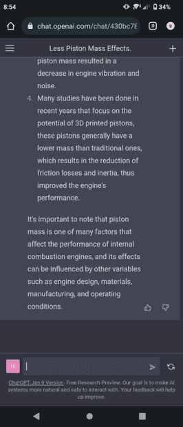

Unacceptable references -- User warned that SI chatbots are not acceptable references in the technical forums
So, I decided to ask ChatGPT what it thought about the subject 😁
Here is probably the real mechanism behind it, which explains my thinking: lower piston mass can increase the mean effective pressure of the engine.
Reciprocating Inertia: Reducing the mass of the pistons can decrease the reciprocating inertia of the pistons, which means the pistons can accelerate and decelerate more quickly. This allows for a more rapid combustion process and an improvement in the MEP.
Combustion Duration: A reduction in piston mass can also decrease the combustion duration. As combustion duration is reduced, the pressure inside the cylinder increases, resulting in an improvement in the MEP.
I also just asked, "studies done on piston mass". Results? INCREASES IN POWER.
  • #35
This is complete nonsense. We already determined that the piston acceleration depends only on the RPM and stroke of the engine; the average over a cycle always being zero (at constant RPM).
The only way to reduce the combustion duration (in crank angle) is to reduce the piston speed at TDC. A lower acceleration will achieve that, which only depends on a shorter stroke and/or lower RPM in a traditional engine. The combustion time will remain more or less the same no matter the piston speed. Thus the flame front will have to "chase" the piston at high RPM, getting further away from the ideal constant-volume combustion of the Otto cycle (i.e less efficient). This is the main reason why mean piston speeds higher than 30 m/s are never achieved.
What is said there is about lowering friction force, and vibrations which can all lead to more power. You already mentioned the friction in the OP:

ChatGPT is not a valid source of information. Stop looking for things you want to hear and embrace the already-established science. Basically, all you have to do is a Free Body Diagram (FBD) to answer your question:
You conveniently left out the conclusion by the NREL study showing piston mass to increase MEP.
"A study by the National Renewable Energy Laboratory (NREL) found that reducing the mass of the pistons in a spark-ignition engine improved the engine's thermal efficiency by up to 3%. This was attributed to the reduction in the reciprocating inertia of the pistons, which in turn allowed for a more rapid acceleration of the engine and an improvement in the mean effective pressure."
The study results make sense if you don't overthink it.
Work done at a faster rate equals more power.
Work can be done faster with lighter reciprocating components.
There aren't some magical parasitic forces that increase to counteract all the increased work that becomes available; some of it goes to engine output.
jack action said:
jack action said:
(The answer should be "no".)
There are at least 4 studies that say yes.

I don't think I cherry picked anything. So far, there is mostly conjecture on whether or not reciprocating inertia increases power. Just people stating off the top of their heads what they think.
What I've found though various studies and my own data is that lower piston mass does increase power. Whether through reduced friction due to mass, lower bearing loads, and or less reciprocating inertia.
I used basic dynamics equations to compare identical engines with 2 different piston masses, posted earlier. There is a clear increase in the rate that torque is generated due to lower reciprocating inertia. It allows the work to be done faster by the combustion gas expansion. The energy is produced faster and given back to the rotating components faster.
I figured it would be easy for someone to confirm or refute these claims with a few equations. I understand not everyone wants to take their time to explain it
