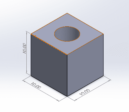

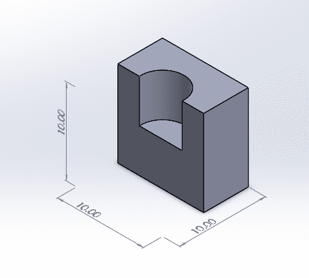

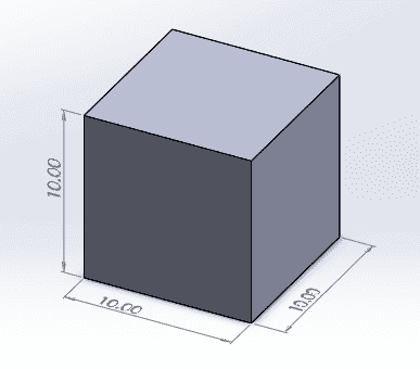

At first, I think it's better to understand about 3D modeling methods even very briefly
for Everyone who want to print the model from 3D Printer and who wants to draw models for 3D printer
you should understand about how STL format file works, and about other 'format'
Let's think about that you are designing piece of 10x10mm rectengular box in 3D Model.
You may consider which CAD or Modeling tool is better for Draw a Box?
In this case i will choose CAD Program for Modeling because it is a way easier to input dimension to BOX model.
Also CAD Tool is based on Solid Modeling.
Means if i draw a 10x10mm box and look inside of it is completely solid (watertight)
Now if i make 5 Pie hole's which going down for 5mm on top of the boxes
than still the box model is solid because it's solid model.
And you could even see solid surface with sectional view

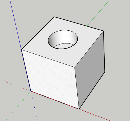

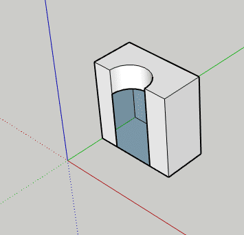

Lets think about other Modeling tools like Sketchup
i often say sketchup is kind of surface modeling tools.
You can see it is complete same with Rectengular box model above
Only just outside of the box.
If you Cut right middle of the box you can see it is empty in side.
This is excellent demonstration of STL format and Solid type 3Dmodel format
The reason of 3D printer requires Water tight model is that.
If it is not watertight, the boundary of wall and inner volume of model is not clearified.
and this will be trouble when generating gcode,
So 3D printing Model need watertight and boundary clear model.
Likes fog37 and berkeman

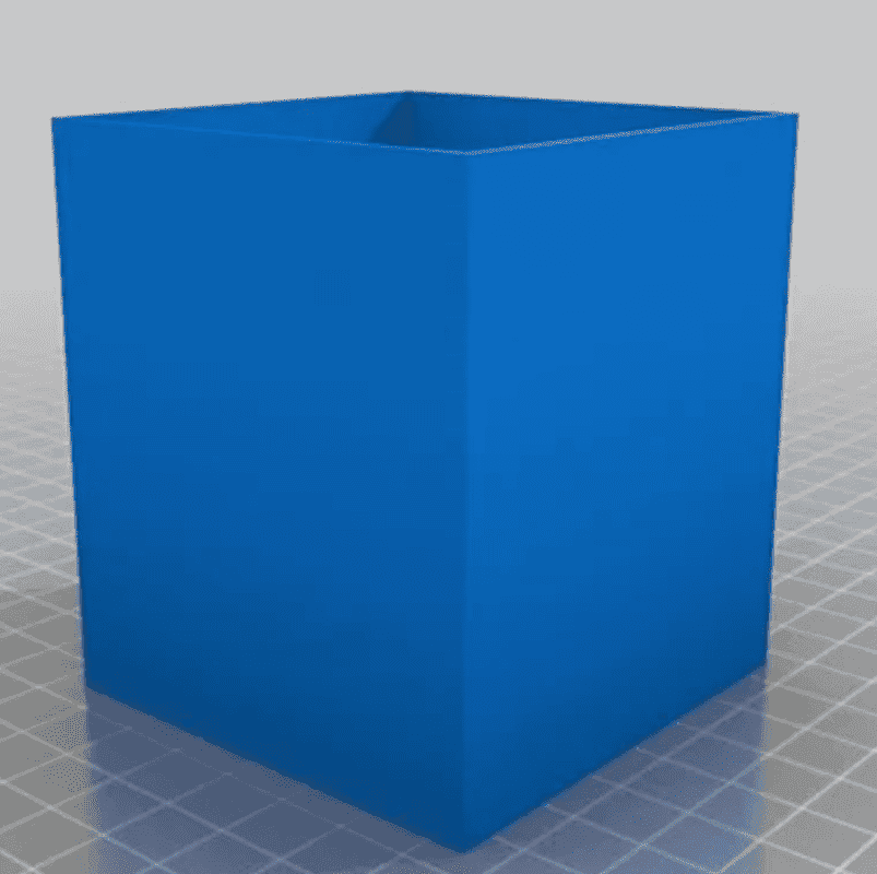

On a similar note, I have a doubt about wall thickness in the digital file and printed wall thickness.
For example, I create a box in CAD (see picture below):
The wall of the box is set to have a certain digital thickness, say 2 mm. After importing the stl file i the slicer, we can set the number of shells/perimeters. What would happen if we chose 4 shells?
In general, I read that the overall wall thickness should be a multiple of the nozzle diameter. I guess it cannot physically be less than the width of a single layer which is ideally 1.2X the nozzle diameter.
Will the 3D printer print a 2 mm wall thickness for the box (what we designed in the CAD) or will it create a wall made by 4 shells for an overall thickness larger than 2 mm?

Since regular low cost 3D printer has poor precision quaility you may dissapoint on the overall quality .
The slice software (Cura,ETC...) will generate gcode which has same diemension with 3D model.
at this point even if wall thickness option has set to 4mm, slice software will recognize seperately from the orignial 3D model and it will not exceed from 2mm wall from orignal one.
However in the view of practical,precision use of 3d printing is limited because there is so many environment variable like nozzle hole diameter, air flow, temperature and humidity, even the materials status.
On my opinion wall thickness option is for big model, which need to be more hard, or less hard
so it will not affect anything for your models in process of printing
