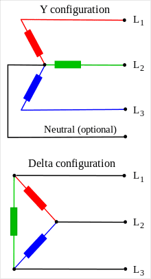

No. Check out https://en.wikipedia.org/wiki/Three-phase_electric_power. The article contains a drawing:
And a short notice: "There are two basic three-phase configurations: wye (Y) and delta (Δ). As shown in the diagram, a delta configuration requires only 3 wires for transmission but a wye (star) configuration may utilise a fourth wire. The fourth wire, if present, is provided as a neutral and is normally grounded. The "3-wire" and "4-wire" designations do not count the ground wire used above many transmission lines, which is solely for fault protection and does not carry current under non-fault conditions."
That surprises me. Seems extremely dangerous to me as these lines float with respect to ground, meaning they can be at any potential including a leak, capacitive or inductive coupling from a 10kV primary for example. Furthermore RCDs are no longer functional in such configuration.
  1. The center of the delta is grounded at the local supply transformer (5kV-230V).
  2. Every house must provide a local safety ground connection. It is not connected to any of the supply wires.
  3. Both wires are considered "live".
  4. I do not know exactly what an RCD does, but from about the year 2000, every fuse in the fuse cabinet must include a Ground Fault Interrupter circuit. A GFCI works by measuring the current leaving one side of a power source (the so-called "live" or "hot wire"), and comparing it to current returning on the other (the "neutral" side). (cited from https://simple.wikipedia.org/wiki/GFCI). Thus, the potential on the wires relative to ground is completely irrelevant.
There's some "inconsistencies" here.
1. Delta windings don't have a center, that's the nature of the problem
2. That's the case in most parts of the world but has only meaning if the supply side is grounded as well. A return path via the Earth must exist for earthing to be functional
3. Understandably
4. Aaah, you make use of a GFCI. Difference with a RCD is that the latter trips in case of a ground failure. A GFCI only tells you the problem is there. Someone has to come and fix it ASAP. It's called an IT-system. That also means that high impedance grounding must exist at the supply side either via one leg of the transformer or an artificial neutral point.

Yes, but the supply transformers do not have to be in a delta configuration in order to supply three-phase delta. They may just as well be in a wye configuration and then it is easy to ground the center.
