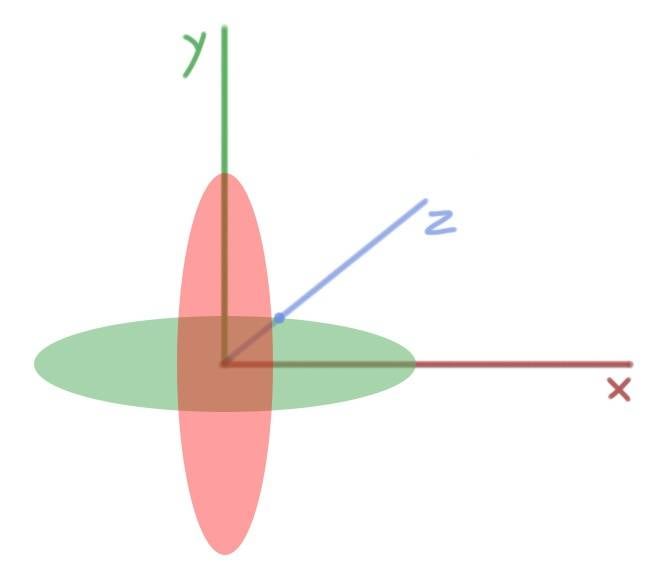

This is what happens with the 3 rotation matrices multiplied by the identity matrix. X and Y rotate the point, Z just has it sitting there.
The way I understood your vector explanation, I thought I could somehow move the "point" (I want to rotate) away from the Z-axis, e.g. along the X-axis, so that the Z-axis can rotate it. I suspect I have some major misconception here, but i read a lot of articles and just don't get it.
I'm extracting the point location from the third column of the resulting matrix.
Think about it. If you're rotating about the z-axis, points on the z-axis can't move. They're on the rotational axis.
For any rotation in 3D, there's going to be some axis along which points won't move. You need to specify exactly what kind of rotation you want.
I'm aware of that, check my first post. My question was about how to move the point away from the Z-axis; that part doesn't seem to work as I expect it to. In above image, I would want a rotation that adds the third circle to the existing two.
You're not being very clear then. You're saying you're using a rotation about the z-axis that you know does not affect points on the z-axis, but you don't understand why those points don't move away from the z-axis. You must be leaving an important detail out.

Sorry, it's still not clear what you mean. A rotation matrix maps a vector (x, y, z) to a vector (x', y', z').
I'm not sure what your intended role is for the identity matrix here. I'm guessing that you're taking each column to represent a vector. (Actually rows, not columns, since you're multiplying by the rotation matrix on the right.) By modifying the matrix, all you're doing is reordering or choosing slightly different vectors to be rotated.
If a rotation doesn't affect points on the z-axis, then it's not going to affect points on the z-axis regardless of which vectors you use or how you arrange them. If you want a rotation that does move points off the z-axis, you need to use a different rotation, not different vectors.
It would help if you gave specific examples of rotations about the x and z axes to illustrate your point.
I also don't get why you use the identity matrix here? And why do you need 3 rotation matrices? No matter what the rotation axis is you only need one matrix.
Maybe you should first try a few 2D rotations using a matrix to understand it better before going 3D.
