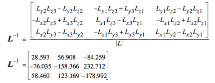

Hi!
I have the 3x3 matrix for L below, which I calculated. But now I need to figure out how the equation below actually means! Is it just the inverse of L (L^-1)? I cannot proceed if I don't know this step.
See image
I put in the values in the calculator, but still get a wrong answer. You can see the 3x3 matrix and the values.

It looks to me like they are using Cramer's Rule to get the inverse.

Sorry if I wasn't clear enough. It's an example from a book and I try to understand how they got the results. Note that I just want to understand how they solved this part and they don't show how.
I put in the values in my calculator and did the inverse btw., still wrong. The first image is the one with their L values

No, both are from the book, which is in PDF form . They did some calculations and got the L matrix, which is the first attached image And then, I have no idea how, they performed a matrix operation and received the values in the second image. I haven't calculated anything yet, I just need to understand how they did this this.
i.e. , the matrix is (from the beginning):
L= [0.9473 0.5742 0.3007
0.0155 0.5747 0.7399
0.3201 0.5830 0.6018 ]
the operation (inverse of the unit vector L? The formula can is in figure two) gives:
L^-1=[28.593 56.908 –84.259
–76.035 –158.366 232.712
58.460 123.169 –178.99 ]
How exactly? :S When I type [L]^-1 in the calculator, I get:
[L]^-1 =[109.126 226.537 -330.791
-300.197 -630.505 918.900
232.764 490.312 -712.583]
completely wrong

Check to see if your calculator expects to see a matrix entered by rows or by columns.
When I put L into Wolfram Alpha, the L-1 returned is pretty close to the printed version. The differences can be attributed to round off.
If you multiply a matrix by its inverse, you should get the identity matrix as the result. This is how you check your calculations.

Did you actually try to calculate the inverse using the formula in the book?

When I use Maple to compute the inverse, I get something close to the book's answer:
[tex] L^{-1} = \pmatrix{ 28.8646 & 57.4696 & -85.0803 \\
-76.8017 & -159.951 & 235.031 \\
59.0493 & 124.386 & -180.773} [/tex]
Rounding errors are not an issue with Maple's result, because I input the elements of the matrix ##L## as rational numbers (instead of decimals), then had Maple do the exact rational inverse, printing out the results as decimal numbers after all computations were completed. I also checked that ##L^{-1} L = I##, as it should.
I truly do not understand how your calculator's answer was obtained, but I can suggest you try to verify at least some of the entries directly, using the algebraic formula given in the book.That might help you decide if your calculator's inversion routine is reliable or not----valuable information for the future.

Oh, that's nice. Yeah, I thin that I need to check that out. It's strange that it gives me the wrong answer. But about the Maple. I tried this with Matlab by inserting:
A=sym([0.9473 0.5742 0.3007;0.0155 0.5747 0.7399; ;0.3201 0.5830 0.6018])
inv(A), AND got the same answer as I did with my calculator. What did you write on Maple, because I'm clearly thinking wrong here.

Never mind, I'll calculate it online instead. Thanks for the help, now I know that the calculator is the issue. Sat with this in an hour or so without knowing it. Cheers!

If I take C = your calculated Inverse(L), and test it, it fails: neither C.A or A.C is near equal to the unit matrix I.
In fact, C.A = [[1.0001, -0.00019, 1.3589],[-0.00956,0.99436,-3.7859],[-0.00006,-0.0005, 3.9415]] = [row1,row2,row3]. The final column is [1.3589,-3.7859, 3.9415], which is nowhere near [0,0,1]. I doubt that Matlab could have given you such an incorrect inverse matrix like C, so I can only conclude that somehow your inputs must be incorrect.
The Maple commands I used were:
with(LinearAlgebra): <----- loads the linear algebra package
A:=
<---- entered as <column1|column2|column3>
(This prints out the correct matrix A exactly as you have presented it). To get the inverse is a snap:
B:=MatrixInverse(A);
Here are the results, printed out to 6-digit accuracy:
[[28.8646, 57.4696, -85.0803],[ -76.8017, -159.951, 235.031], [59.0493, 124.386, -180.773]] = [row1,row2,row3].
