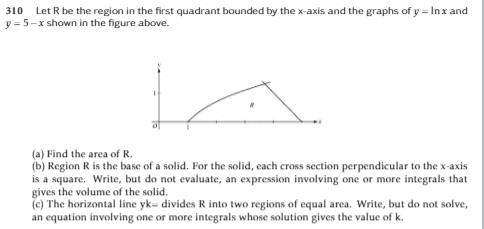

ok I got stuck real soon...
.a find where the functions meet $$\ln x = 5-x$$
e both sides
$$x=e^{5-x}$$ok how do you isolate x?
W|A returned $x \approx 3.69344135896065...$
but not sure how they got itb.?
c.?

FYI, this is a calculator active problem ...
$y = \ln{x} \implies x = e^y$
$y = 5-x \implies x = 5-y$
$$R = \int_0^{1.3065586} (5-y) - e^y \, dy = 2.986$$

so then we don't need to know x of the intersection
yes, you need both x and y coordinates of the intersection point ...
(a) can be done w/r to x or y ... I went w/r to y because it only requires a single integral expression
(b) requires x ... two integrals
(c) requires y
ill go with c
karush said:
ill go with c
(c) is a free response question, not a choice
