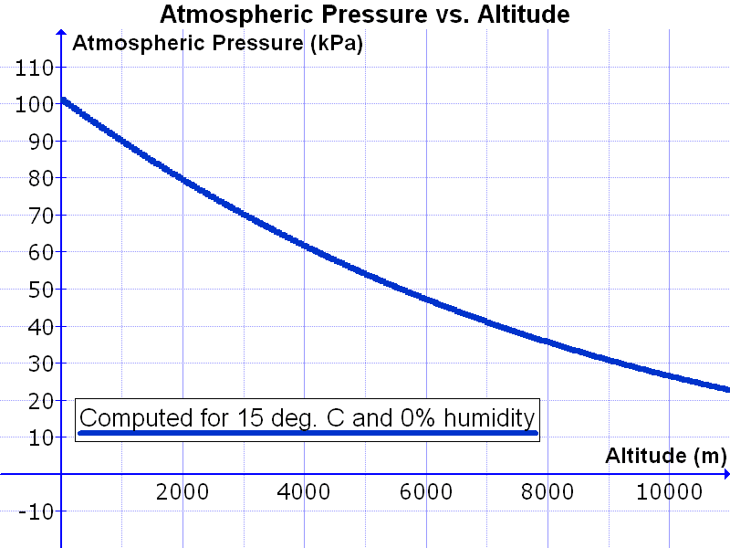

An aircraft's engine performance decreases with altitude due to decreasing atmospheric density; the higher you go in the atmosphere the lower the density of the air. Because of this, there is less oxygen available for combustion.
Atmospheric pressure variation as a function of altitude:
https://en.wikipedia.org/wiki/Atmospheric_pressure
A 4-stroke engine will be especially limited unless a form of forced induction is utilized such as a supercharger. See here: https://en.wikipedia.org/wiki/Supercharger#Aircraft
Wikipedia.org said:
Superchargers are a natural addition to aircraft piston engines that are intended for operation at high altitudes. As an aircraft climbs to higher altitude, air pressure and air density decreases. The output of a piston engine drops because of the reduction in the mass of air that can be drawn into the engine. For example, the air density at 30,000 ft (9,100 m) is 1⁄3 of that at sea level, thus only 1⁄3 of the amount of air can be drawn into the cylinder, with enough oxygen to provide efficient combustion for only a third as much fuel. So, at 30,000 ft (9,100 m), only 1⁄3 of the fuel burnt at sea level can be burnt.[14]
