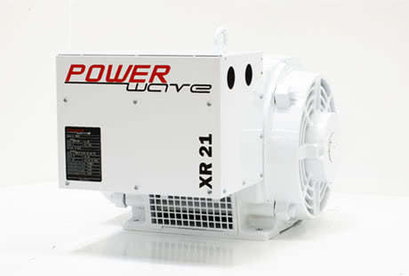

In theory, I suppose you could use a motor-generator.
It would be expensive but a special 3Ph supply installed in your home would really cost you a lot. You could always look around for a s/h motor generator set. Moreover, you could move house and take the generator with you!
It's an actual thing:
https://en.wikipedia.org/wiki/Rotary_phase_converter
A rotary phase converter, abbreviated RPC, is an electrical machine that converts power from one polyphase system (including frequency) to another, converting through rotary motion. Typically, single-phase electric power is used to produce three-phase electric power locally to run three-phase loads (any industrial machinery with three-phase motors) in premises (often residential or consumer) where only single-phase is available.
https://temcoindustrial.com/product-guides/phase-converters/rotary-phase-converters
I've seen odd-voltage transforming on process equipment implemented a bunch of times, but only once ever seen a rotary phase converter applied. It's pretty rare in commercial/industrial applications to have both single phase power and a large power need at the same time.
