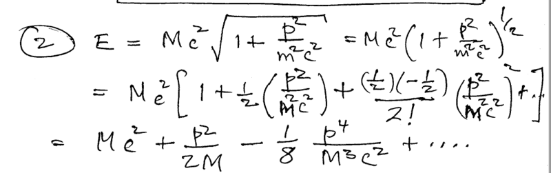

But that's not right. The answer key has the following answer (and so does Wolfram) $$ f(p) = 1 + \frac {p^2} {2m^2c^2} - \frac {p^4} {8m^4c^4} $$
A picture of the answer key soln is below. Ignore the factor of ##Mc^2## outside the approximation.
I noticed that the answer doesn't even get any of the derivatives equal to 0, and I was getting all the odd derivatives equal to 0. That makes me think I'm applying Taylor's formula incorrectly and it's more than just an algebra mistake?

Taylor expand ##\sqrt{1+x}## to second order in ##x##. Set ##x= p^2/(mc)^2##.

Oh I suppose that would be easier. I think that's what the answer key did. I'm kind of wondering why are we allowed to substitute in expressions for variables that would carry different inside derivatives when applying the chain rule? Maybe that will clear up when I'm able to fix my algebra but I'm just curious.

Just think about the meaning of a Taylor series. If ##f(x)=\sqrt{1+x}\approx 1+\frac{1}{2} x## when ##x=0.00001##, then when ##y=0.001##, ##y^2=x## so we should get that ##f(y^2)\approx 1+\frac{1}{2} y^2##. If there was some better approximation in terms of y, you could just use that to get a better approximation of ##f(x)## in terms of x

Must have something to do with the fact that a function of ##p^2## is even, so a Taylor expansion can't have any odd powers of ##p## in it . . .

I think the answer key is using the binomial series for [tex](1 + x)^\alpha = 1 +
\alpha x + \frac{\alpha(\alpha-1)}{2}x^2 + \dots + \frac{\alpha(\alpha-1) \cdots (\alpha - n + 1)}{n!}x^n + \dots, \qquad |x| < 1,
[/tex] with [itex]x = p^2/(mc)^2[/itex] and [itex]\alpha = \frac12[/itex].
