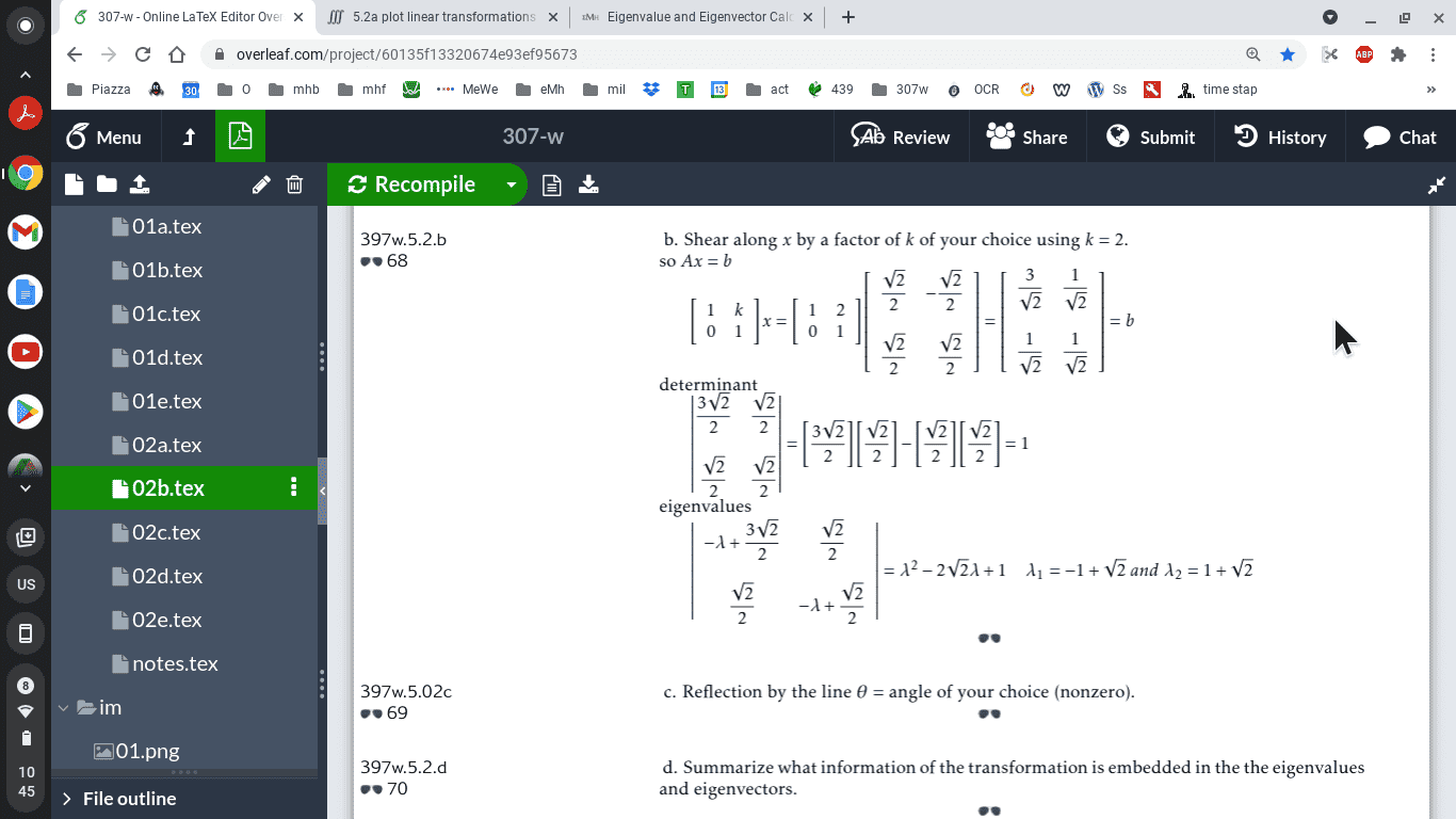

ok we are supposed to go to here
Find 3 different matrices that reflect the following transformations, report the matrix, the determinant, and the eigenvalues.
1. Rotation by $\dfrac{\pi}{4}$
2. Shear along $x$ by a factor of $k$
3. Reflection by the line $\theta$
there are some more but the site asked for doesn't return the transformed matrix just a morphed image
also I presume we doing all 3 matrices with just the matrix's used in the site
I tried geogebra and W|A also but the plots didn't look like vectors
anyway this is due on Friday so hope I can get it right. I am sure the answer is relatively simple
ok here is what I did for shear k=2
probab'y would have been better for $k=\sqrt{2}$
I don't understand this phrase. What matrix is used on the site? To me the problem seems to ask to find three separate matrices, their determinants and their eigenvalues.
