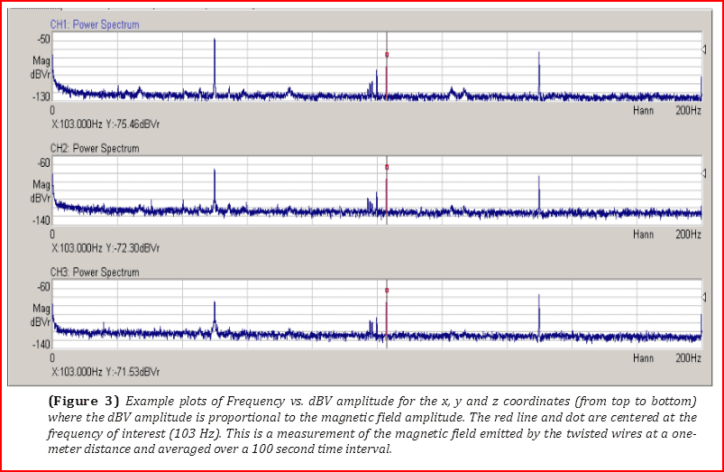

Although, There was an experimetn carried out by California State University where they showed twisting 3phase 50Hz cables drastically reduced the Radiated Emissions - there is just no formulas derived from the data. (http://www.phys.ufl.edu/ireu/IREU2013/pdf_reports/Daniel_Vander-Hyde_2_experimental.pdf)
The paper shows "drastic" (10 fold) reduction only for standard two wire single phase power. This is not new science..

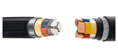

@berkeman is right, I don't recall twisted power cables. But they can be bundled in a cable with a shield level around the outside. The shield can contribute both tensile strength and electromagnetic shielding.
That is for a very special situation, where power frequency B-fields were interfering with the Virgo Gravitational Wave Detector. That is certainly unwanted interference, but nothing like what most of us deal with in the MHz-GHz range for traditional Radiated EMI compliance. :smile:
This is the frequency range they were testing over (power frequency range of 10s to a couple 100 Hz):
