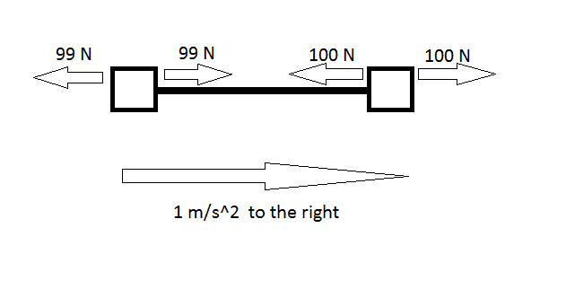

Thank you. If I may, suppose my friend, standing on the left side of the string, continues to pull with a force of 99 N while I, on the right side of the string increase my pull to 100 N. Does the string have 99 Newtons on Tension, 100 Newtons, or a combination? Does my friend on the left feel 99 N of force pulling or 100? Do I feel 100 or 99 N?
It will have a tension gradient, going from 100N on your side, to 99N on his side. An the whole thing isn't static anymore, because the forces don't balance.
The string pulls on you with same but opposite force as you pull on the string. Same for your friend.
Likes Ocata

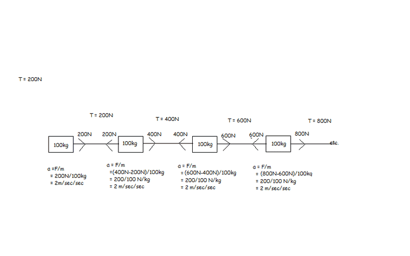

Would the attached image provide an accurate representation of the description you provided?
If so, then what, may I ask, does the rope feel in the middle? Suppose you choose a point exactly in the middle of the rope and measure its tension. Would it be 100 N, 99 N, or 100 N in one direction and 99 in the other direction?
Placing the force arrows is difficult if you don't separate the bodies like shown here in step 3:
http://adaptivemap.ma.psu.edu/websites/structures/analysis_of_frames_and_machines/analysisofframesandmachines.html
Assuming a uniform mass distribution in the rope it would be 99.5N.

Suppose I divide the one 1000kg blocks into ten 100kg blocks (numbered 1 through 10 with the 1st on being on the far left and the 10th one being on the far right) and I pull with 2000N on the RH side of the 10th block. The entire acceleration will equal 2000N/1000kg = a = 2m/s^2 and each box will have a force of 100kg(2m/s^2) = 200N. The force meter connected to the string on which I am pulling will read 2000N. If a force meter is connected between each 100kg block, will each of the 9 force meters read 200N for a total of 1800N or will each force meter read a consecutively smaller number? In thinking about your explanation earlier for why the block is more likely to rip apart with an opposing force, I'm going to guess that the force meters will read consecutively smaller numbers. If so, would they read like this: F = ma => 100kg(9)(2), 100kg(8)(2), 100kg(7)(2), ..., 100kg(3)(2), 100kg(2)(2), 100kg(1)(2)
So if you were to offset the Styrofoam division in the original 1000kg block to the far right within the block and pulled the RH string to the R with 1000N, it would be much more likely to rip apart than if you were to offset the Styrofoam division to the far left within the block, yes?
