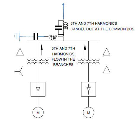

In summary, the author says that by shifting one load 30 degree with respect to the other, we can cancel out the 5th and 7th harmonic. However, if we only shift 30 degrees, we can not completely cancel them out.
BjornFanden
Hi,

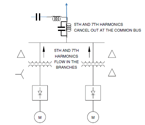

I do not see how this method (illustrated in the figure below), can completely remove the 5th and 7th harmonic?
I know that in a wye-delta connection a 30 degree phase shift is introduced. But to fully remove the 5th harmonic we need a phase shift of 180/5 = 36, and for the 7th harmonic we need 180/7 = 25.71.
Since 36 and 25.71 degree is Close to 30 degree I assume they get greatly reduced. So parhaps they should not write "cancel out at the common bus" to avoid any confusion?

Thank you for replying.
But I am just curious when the Author of the book (Power Quality by C. Sankaran) says that by shifting one load 30 degree with respect to the other, we can cancel out the 5th and 7th harmonic, assuming the loads are equal etc.
But we can not cancel them completely?
Lets say we have to 5th harmonic loads connected in parallel, and they are shifted 180/5=36 degrees, if they are shifted 36 degrees with respect to each other they would completely cancel if they were identical, correct?
However, if we only shift 30 degrees, we can not completely cancel them out, even if they are identical. But 30 degrees is kind of Close to 36 degrees, so we can some cancellation, and that is what the Author means when he says that 5th and 7th harmonic cancel at common bus, correct?

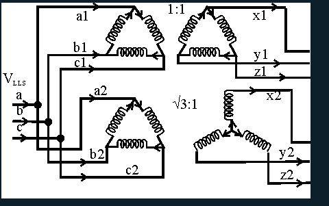

Hi, I think that full cancellation is theoretical possible if the loads are equal, here's why:
In the delta-delta the currents are the same at primary and secondary.
[itex]a1 = x1 = sin(5 \omega t)\\b1 = y1 = sin(5 \omega t - 120^{\circ})\\c1 = z1 = sin(5 \omega t + 120^{\circ})[/itex]
for the delta-wye we have on the secondary side:
[itex]x2 = sin(5 \omega t+30^{\circ}\times 5) = sin(5 \omega t+150^{\circ})\\
y2 = sin(5 \omega t - 120^{\circ}\times 5 +30^{\circ}\times 5) = sin(5 \omega t -90^{\circ})\\
z2= sin(5 \omega t + 120^{\circ}\times 5 +30^{\circ}\times 5) = sin(5 \omega t +30^{\circ})[/itex]
Going from secondary to primary we have to include the [itex]\sqrt3:1[/itex] ratio
[itex]A2= (i_{a}-i_{b})/\sqrt3 = (sin(5\omega t+150^{\circ})-sin(5\omega t +30^{\circ}))/\sqrt3 = -sin(5 \omega t)[/itex]
Similar can be shown for b2 and c2 that they are equal to b1 and c1, respectively (for 5th harmonic).

In my opinion, since the apparent power on low-voltage side is equal to apparent power at high-voltage side and the line-to-line voltage is the same the line current has to be the same. So no correction of sqrt(3) is required.
However, the winding turns ratio has to be w1/w2=sqrt(3).
