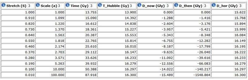

I have done an experimental version of A20 with the distance of the cosmic event horizon added. It required increasing the number of integration step significantly, because it has to calculate far into the future, so the calculator becomes slower.
It is not all that well tested, so I want to get reaction before finalizing and uploading it for direct access. Here is a screenshot for discussion. Due to the increased number of integration steps, some of the values are marginally different. Still evaluating for possible errors.
I think we must carefully consider the descriptions of the (live) info popups so as to not cause confusion with the generalized meaning of distance columns.
Edit: my proposal
D_now
"If positive: present proper distance of a source from which we now receive light with a wavelength stretch S. If negative: present proper distance of a target which will receive our present signals with a wavelength stretch 1/S. Proper distance is like measuring cosmic distances on a hypothetical 'freeze-frame' (no expansion) by means of radar, measuring rods, or similar."
D_then
"If positive: past proper distance (at emission) of a source from which we now receive light with a wavelength stretch S. If negative: future proper distance of a target which will receive our present signals with a wavelength stretch 1/S. See D_now info for definition of proper distance."
D_hor
"The cosmic event horizon, which is the largest distance (at time of emission) between an emitter and receiver that light can ever bridge. At larger distances, accelerating expansion prevents light from reaching the receiver."
I will appreciate suggestions for improvement of clarity.
It's great to have a Cosmic Event Horizon column! the CEH must surely be one of the most interesting dimensions of cosmology. I had assumed that the computational cost would be too great to include a calculation of it---that it would prohibitively slow the generation of the table. Is it really OK to include that much numerical integration? I guess it must be OK! Jorrie may have found a way to make the whole thing more efficient and thus practical.
Right now I can't think of suggestions about wording, maybe someone else can suggest some clear concise phrasing to put in the "info" popups. AFAICS they are already pretty clear and helpful.
My wife and I just got back from a short vacation at a perfect spot on the California coast. It's a pleasure to see this tentative new version of Jorrie's A20 calculator that actually calculates the CEH at any time in the past present future. And let's you vary the inputs parameters of the standard cosmic model and get different everything (including different CEHs).
I still haven't gotten any sense as to how practical it is to build in this addtional computation load. Or if it does slow the calculator down whether Jorrie will choose to pay that tradeoff cost in order to get the new feature. Right now it's pretty amazing. I just generated a table with over 100 rows and the output was instantaneous.
The table went from S=10 to S=0.01 in steps of ΔS = 0.09, so it had over 110 rows, more than I feel like printing in this post. But it went from the formation of the first galaxies (around year 560 million) out to year 88 billion: far in future when distances are 100 times what they are now. So a sweeping panorama of history---from remote past to distant future---and a lot to think about. And the calculator generated it instantly. If I had constructed such an online device would I be willing to add an extra function that would slow it down? I don't know. We will see what happens :biggrin:
In the meanwhile let's see if I can copy Jorrie's brief sample "screenshot" that he posted yesterday---with the extra CEH column.
There is a lot you can get out of even a short table like this. For example it shows us sending a message NOW which eventually arrives at a galaxy when the galaxy is 1550 billion lightyears from here OK? Now suppose you want to know how fast is the distance to that galaxy growing on the day that the message from us arrives?
How fast is that distance 1550 billion ly growing? That's easy with the A20 calculator's table because it gives the THEN Hubbletime. You can always divide any distance by the contemporaneous Hubbletime and it gives the distance's growth speed.
You can see (if the screenshot prints in my post, if not look back at Jorrie's post) that the THEN Hubbletime is 16.3 billion years.
So you just divide 1550/16.3 and it gives the recession speed as a multiple of speed of light on the day that our flash of light arrives at the designated galaxy to which it was addressed.
If you are new to the subject you might want someone to explain how it can possibly get there* and in that case since there are quite a few people around the forum who can explain that you simply need to ask. Or you may already have read the explanation in the Sci Am article by Lineweaver and Davis (the "charley" link at the foot of this post).
Another thing readers might like to imagine is how it will look to us far in future as galaxies sail over the Cosmic Event Horizon. A bit like watching things falling in thru the event horizon of a black hole. there are analogies between a black hole EH and the cosmic EH.
*i.e how could info we send at speed of light ever reach a galaxy which is receding at 95c.
We were within that galaxy's event horizon on the day we sent the message, as likewise it was within ours (see table) and so it CAN reach them eventually---that's what the CEH means. The challenge is to understand it well enough that you can imagine how this happens, and also how it fails to happen if the galaxy is just a little bit farther than CEH on the day we send signal.
As an afterthought just to be emphatically quantitative about it :smile: the above table shows that the TODAY value of the CEH is 15.622 and the today distance to the galaxy is 15.489. (So you are using 2 rows of the table to see that 15.489 < 15.622, and that is what makes it possible for our signal to reach them. That being what event horizon means. And it works both directions---they could right now be sending a flash of light in our direction, from the brink so to speak, like goodby from something close to falling forever into BH. A message destined to reach us but not for 88-14 = 74 billion years. We are within their CEH,as they within ours, but not for too much longer (again see table, as a rough estimate I'd guess two or three hundred million years should see them over the edge ;-)
reminder:https://www.physicsforums.com/showthread.php?p=4069097#post4069097

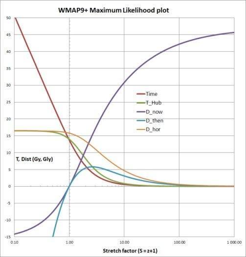

Here is a visual picture of what you will be getting in tabular form:
Looking over to the right is looking deep into the past to when distances were 1/10 today's.
For instance if we see a galaxy with S=9 meaning that its light comes to us wavestretched 9-fold you can see from the figure that the galaxy NOW is 30 billion lightyears away, as the green curve shows.
How far was it back THEN, when it was as we see it and emitted the light? Well, distances and wavelengths have enlarged by a factor of 9 since then. So it must have been 30/9=3.33 billion lightyears away back then. And that is what the purple curve shows.
Another interesting thing you can read off the figure, about the S=9 era, is that the cosmic event horizon was only 5 billion lightyears back then!
Any galaxy from that S=9 era which we are now able to see MUST have been closer than that, at the time.
That's looking over to the right side of the figure, high values of S means deeper into the past.
On the other hand, looking over to the left side we have a compressed picture of the future, from the present S=1 era out infinitely far in the future at S=0. You can see the black curve of time, the yearcount, blowing up to infinity. You can see the distances to any galaxy we can reach with a flash of light we send today. Its distance from us NOW (green) and its distance from us THEN (purple) when the flash arrives. You can see that distance at arrivaltime also going off to infinity, along the purple curve. And the distance from us now approaches a finite limit which is today's cosmic event horizon. Any galaxy beyond that limit we have no hope of sending light to, as of today. Though past light from us, or from our Milky Way galaxy, may already be reaching them or in the process of getting to them, assuming they were within event horizon range when the light was emitted. That event horizon distance is shown by the sky blue curve.
It's current value is over the S=1 mark representing the present. Going up the S=1 vertical line you can see it is slightly over 15 billion light years currently (I think the exact figure is about 15.6)
There's a lot more that you can read from the figure, or from the corresponding table.
Recall that to get the table you just type upper=10, lower=.01, and stepsize=-30, say, to specify the desired number of rows.
