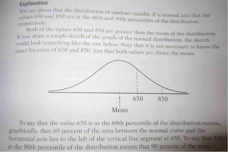

I am attaching the diagram.
Can somebody please point out where 750 would lie in the attached graph and where the value of 75th percentile would lie? This would help me to find out whether 750 is greater or 75th percentile is greater.
Zulfi.

No, there is technically no easy way for anybody to point out on the graph where the 75th percentile would be. Anyway, locating the 75th percentile is YOUR job, and you should do everything you can to finish the task. You have been told several times how to find the 75th percentile: consult a table of the standard normal distribution. You say that in an exam you would not have access to a "normal" table, but that is irrelevant here: you are posting a message, not writing an exam.
That being said, you can answer the question for yourself as to whether the 75thpercentile is less than or greater than 750. On the graph, the point at 750 cuts the area under the graph (between 650 and 850) into two parts. Just looking at the picture, do you think that the area between 650 and 750 is equal to the area between 750 and 850? Basically, the 75th percentile ##p## is determined by making the area between 650 and ##p## equal to the area between ##p## and 850.
On an exam, that type of analysis might be sufficient, even without having a normal table available.
