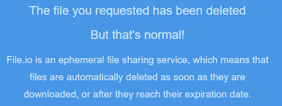

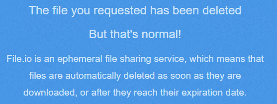

Is that the reason your link is a dud ? :
I successfully downloaded it, installed maple to read it. Didn’t get very far and was unable to find his missing factor.
Must have been a short lived link. I don't usually need to upload for public use, so I just took the first and best google suggestion.
