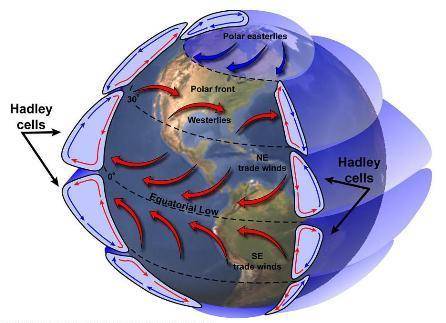

There is certainly drag by the Earth on the atmosphere. At the Earth's surface, the air speed is very low, but aloft the air speed is much higher. Look at the jet stream.
Gravity affects the atmosphere through buoyancy effects vis-à-vis differences in density in regions of air, and by the Coriolis affect. The sun provides plenty of energy to the atmosphere to keep things moving.
An example of the effect of drag -

The "crosswind" is the Jet Stream, it's a weather effect caused by the coriolis effect and regular wind. If the Earth was not heated by the sun and thus had no wind, there would be no jet stream. This is totally different from other things you were discussing.
Note that there is a southern jet stream and it flows in the opposite direction of the northern one.
No I was referring to what Nugatory was talking about. If you stay at the same latitude, you will have the same rotational speed that you started with. If you are at the equator, you would already be moving at 1000 mph with the rotation, so it would be like walking in a plane traveling at 1000 mph; it wouldn't be harder to move forward, back, or side to side because you were already moving with it. So going east or west would not have any effect. It would, however, have an effect if you moved north or south because those points aren't moving as fast as the equator. For instance, a point north of the equator might be rotating at only 900 mph because it is not as far out on the curvature of the Earth (not as far from axis of rotation). Thus, you would have a 100 mph speed difference if you moved to that point.
That's the coriolis effect and it has nothing to do with wind/the atmosphere: it applies in a vacuum, causing a projectile to appear to curve as it moves north or south.
