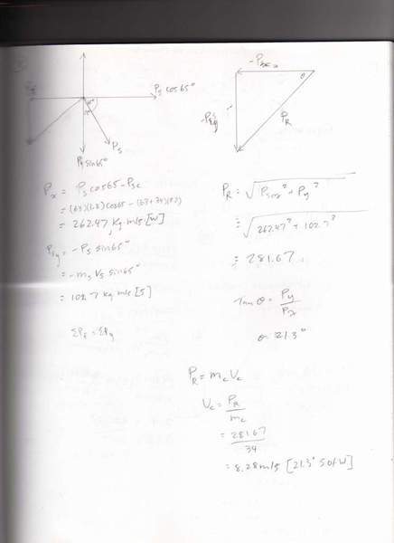

A 63-kg student stands on a 34-kg cart that is free to move in any direction. The cart and student are moving together with a velocity of 3.2 m/s [W]. The student then starts to walk so that her velocity is 1.8 m/s [25° W of N] relative to the floor. Calculate the new velocity of the cart.
p=mv
i don't know what is going on
p=mv
why is the direction point to 25 degrees E of S
