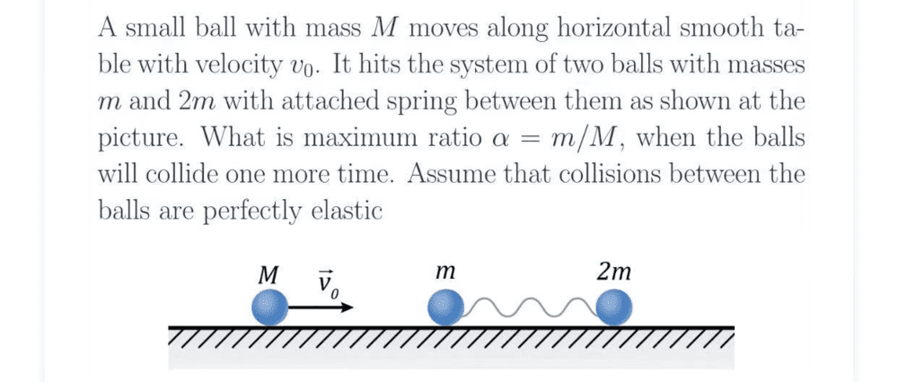

See below chart. A ball with hit a two ball system with a spring in between. What's the maximum ratio of masses so the balls will collide one more time.
The law of momentum conservation, The law of energy conservation
I honeslty don't quite know how to start. It seems like the Hooke's coefficent k is independent of the answer to this problem.
I would also appreciate any clue of expressing the condition when "balls will collide again". The fact that all balls can keep moving make this rather difficult.
It seems to me that "balls will collide again" when the speed of M is greater than the speed of the spring attached system (I could be wrong)? But that doesn't help much since the problem only tells me the collision is elastic.

Here's how I would start. For the initial collision between the ##M## mass and the ##m## mass, assuming this collision is perfectly elastic and instantaneous, the impulse by the spring on the ##m## mass will be zero [since there is, initially, zero extension of the spring]. That means, for this first collision you can ignore the spring, and determine the speeds of the ##M## mass and the ##m## mass just after this initial collision as you would for a simple collision problem.
Then, if the speed of the ##m## mass just after this first collision is ##v## in the lab-frame, the centre of mass of the ##m## & ##2m## mass-spring system moves at ##v/3## in the lab-frame.
In the centre-of-mass frame of the ##m## & ##2m## mass-spring system, the two masses are performing independent oscillatory motion about their initial positions, with the centre of mass stationary. The velocity of the ##m## mass in the centre-of-mass frame of the ##m## & ##2m## mass-spring system right after the initial collision is ##2v/3## to the right.

I think the easiest is the obvious full-frontal approach: to write the equation of motion of mass m and find the closest approach to mass M. None of the usual shortcuts seem to work.

The mass M might strike mass m during the latter's first relatively leftward movement even if the CoM of the two sprung masses moves faster than M. Bear in mind that m starts with the spring at equilibrium; later on it will have a greater length half the time.

Timing is important too. Even if the CoM speed of the sprung masses only slightly exceeds that of M, the oscillation won't succeed in making contact if it comes too late.

I ended up with a condition that, in order for the ##m## and ##M## masses to never collide again, we require that$$(\forall t \in [0, \infty))\, \, \sin( \mathcal{w} t) > \frac{3wt}{2} \left( \frac{M-m}{2M} - \frac{1}{3}\right) = \frac{3 \mathcal{w} t}{2} \left[ \frac{1}{6} - \frac{\alpha}{2} \right]$$where ##\mathcal{w} = \sqrt{(3k/2)/m}## and ##\alpha = m/M##. Since the RHS is linear, this just requires that at ##t = (3/4)T = (3/4) \cdot (2\pi / w)##, the RHS is less than ##-1##, i.e.$$\frac{9 \pi}{4} \left[ \frac{1}{6} - \frac{\alpha}{2} \right]< -1$$which we can then solve for ##\alpha##, and then finally negate the statement to find the maximum ##\alpha## at which they do collide again.

To find the necessary and sufficient condition on C s.t. ##\sin(\omega t)>Ct## for all positive t we need to find C s.t. y=Ct is tangent to ##y=\sin(\omega t)## in the range ##\pi<\omega t<\frac 32\pi##. I.e. solve ##\sin(\omega t)=Ct## and ##\omega\cos(\omega t)=C##.
Squaring and adding to eliminate the trig gives ##t^2=\frac 1{C^2}-\frac 1{\omega^2}##, which only has a solution if ##|C|<\omega##, but I'm not sure what to deduce from that.

I think the question setter has underestimated the subtlety and difficulty of the problem.
I think you guys have outlined how to solve it. I have no new insights. When I work it through, I get an answer that doesn't depend on ##v_0## or ##k##. But the answer does depend on the root of a transcendental equation which arises from @etotheipi's "gradients of the two curves are equal". Here's what I get in case anyone wants to compare answers.
##\large \frac{m}{M} = \frac{1-4\cos\beta}{3}## where ##\beta## is the smallest positive root of ##\beta = \tan \beta##.
