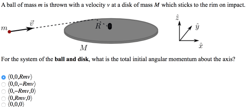

A ball of mass m is thrown with a velocity v at a disk of mass M which sticks to the rim on impact.https://s3.lite.msu.edu/res/msu/perl_author/P3_PRELECTURE/L_CONSERVATION/IMAGES/CQ1.png
For the system of the ball and disk, what is the total initial angular momentum about the axis?[PLAIN]https://s3.lite.msu.edu/adm/jsMath/fonts/cmsy10/alpha/144/char68.png0,0,Rmv[PLAIN]https://s3.lite.msu.edu/adm/jsMath/fonts/cmsy10/alpha/144/char69.png

[PLAIN]https://s3.lite.msu.edu/adm/jsMath/fonts/cmsy10/alpha/144/char68.png0,0,−Rmv[PLAIN]https://s3.lite.msu.edu/adm/jsMath/fonts/cmsy10/alpha/144/char69.png

What is your specific question about this question?
Am I correct?
Yes, [PLAIN]https://s3.lite.msu.edu/adm/jsMath/fonts/cmsy10/alpha/144/char68.png0,0,−Rmv[PLAIN]https://s3.lite.msu.edu/adm/jsMath/fonts/cmsy10/alpha/144/char69.png, using the definition of angular momentum as L=r x p and the right-hand rule (presuming the axis is through the axis of the disk).
