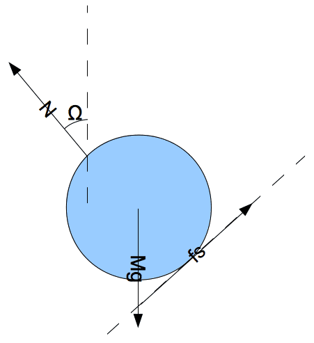

A solid sphere sphere (radius = R) rolls without slipping in a cylindrical trough (radius = 5R) as shown in the following figure. Show that, for small displacements from equilibrium perpendicular to the length of the trough, the sphere excuses simple harmonic motions with a period [tex]T=2\pi \sqrt{28R/5g}[/tex]
[tex]\vec{F}_{net}=m\vec{a}[/tex]
[tex]\vec{\tau }_{net}=I\vec{\alpha }[/tex]
[tex]\left | \vec{a} \right |=R\left |\vec{\alpha }\right |[/tex]
Step1. Draw the Free body diagram.
Step 2. Solve the Newton's Equation
[tex]Mgsin(\Omega )-fs=Ma[/tex]
Take the center of sphere as pivot.
[tex]f_{s}R=(\frac{2}{5}MR^{2})\alpha [/tex]
[tex]a=R\alpha [/tex]
Finally,
[tex]\therefore \, f_{s}=\frac{2}{7}Mgsin(\Omega )[/tex]
Step 3. Take the center of the cylindrical trough as the pivot.
[tex]\tau _{net}=[-Mg\times 4Rsin(\Omega )]+[\frac{2}{7}Mgsin(\Omega )\times 5R]=(\frac{2}{5}MR^{2}+M(4R)^{2})\frac{d^{2}\Omega }{dt^{2}}[/tex]
[tex]\therefore \: -\frac{18}{7}MgRsin(\Omega )=\frac{82}{5}MR^{2}\frac{d^{2}\Omega }{dt^{2}}[/tex]
[tex]\therefore \: -\frac{45}{287}\frac{g}{R}\Omega \approx \frac{d^{2}\Omega }{dt^{2}}[/tex]
[tex]\therefore \: T\approx 2\pi \sqrt{\frac{287R}{45g}}=2\pi \sqrt{\frac{31.\bar{8}R}{5g}}[/tex]
I've seen the correct solution but I still don't know why I was wrong.
I will be grateful for any help you can provide.

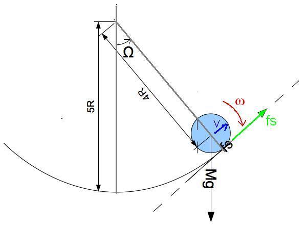

When the ball is rolling down the trough, it is not pivoting about its center, nor about the center of the trough. It is, at every instant, pivoting about its point of contact with the surface.
Likes Philethan
I don't see how that's relevant. You can still treat the ball as moving translationally and rotationally about it's center of mass, which is a useful perspective to find the force of friction. The contact point between the ball and surface may be where it is purely rotating (that is, no translational motion) but it is valid to look at it at other perspectives as well.
Likes Philethan and thecommexokid
I think that the key thing here is that there are two angles that are important. The angular displacement of the ball (what you call Omega) and the angular rotation of the ball (call it theta). In the first part you are talking about the angular acceleration of the ball, and in other parts you are talking about the angular accelaration of the ball on the ramp. I would try to come up with one equation, with a single angle: d^2(theta)/dt^2 + K theta = 0 [or with Omega] to get an equation for a SHO. The two angles are related in a simple way: R * Theta = 5*R*Omega
Working from your Eq. 2., using a single, consistent angle, I think that you should be able to come up with an equation...
Likes Philethan
Philethan said:
##\tau _{net}=[-Mg\times 4Rsin(\Omega )]+[\frac{2}{7}Mgsin(\Omega )\times 5R]=(\frac{2}{5}MR^{2}+M(4R)^{2})\frac{d^{2}\Omega }{dt^{2}}##
The right hand side is wrong. It treats the ball as rotating as a whole about the centre of curvature of the trough, and ignores the rotation involved in its rolling.
Likes Philethan
Thanks a lot! At last, I understand why I was wrong! The net torque equation I wrote down just neglects the rotation involved in its rolling. However, that means I can't use the net torque equation about the center of curvature of the trough because that's meaningless. I can't use the net torque equation unless all points on the object has the same angular velocity about the pivot, right? Is this correct?

It is difficult to follow your derivations. It would be better to use the CM frame of reference.
You also need to show what is the direction of motion of the centre of the ball, and what is the direction of its rotation about the centre.
The ball moves to the right and upward, and rotates about its centre clockwise with angular speed ω. fs has to decelerate rotation, so it points in the direction of the red arrow.
Equation for the motion of the CM:
## M 4R\frac {d^2\Omega}{dt^2}=-Mgsin \Omega+f_s##
Equation for the rotation about the CM
##f_sR=-I \frac{d\omega}{dt} ##
Rolling condition ##Rω=4R\frac{d\Omega}{dt} \rightarrow \frac{d\omega}{dt}=4\frac{d^2\Omega}{dt^2}##
and I=2/5 MR2.
From the equation above you get ##\frac{d^2\Omega}{dt^2}=-\frac{5g}{28R}\Omega ## for Ω small, and fs is certainly not zero for Ω≠0.

Sorry for the delay in replying. It took a while to figure out the flaw in your method.
In effct, you double-counted the frictional force. We need to understand what your calculated "effective moment of inertia" represents.
Forget gravity for the moment and imagine the ball as mounted on the end of a rod pivoted at the trough centre of curvature. Some agent applies a torque to the rod and observes the angular acceleration that results. This ratio is your effective moment of inertia. The agent is unconcerned with what is going on at the bottom of the rod.
So, when writing the left hand side of your equation, you should not subtract the torque of the frictional force from the applied torque. The effect of that force is already acounted for in the calculation of the effective moment of inertia.
