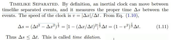

Yuras said:
Excellent analogy. Note though that we don't talk about "height contraction" in this case.
That’s because it does not describe the Euclidean analogy of time dilation, which is two odometers moving from a common point in different directions. Each odometer also projects a line orthogonal to its motion at fixed distances from the start. Both odometers will note that its own 1 m line is crossed by the other odometer when that one shows a number greater than one.
What was described was simply that effects may be symmetrical between observers.
Yuras said:
Time dilation as a concept is a pedagogical disaster. IMO it should have not been introduced in the first place. There is only one time - the proper one. It's too late probably, but on the other hand we somehow managed to (mostly) get rid of "relativistic mass" - another miss-invention of the past.
It has the very same issues as using Cartesian coordinates on Euclidean space. The analogies are abundant. The only reason people “get” Euclidean effects better is that they have more intuition in Euclidean geometry than in Minkowski geometry.

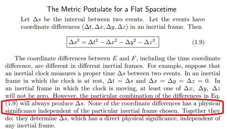

Yes. The combined information about a frame-dependent quantity and the related reference frame is invariant. In the case of the proper time, the reference frame (rest frame of the object) is implicitly included.
There is no reference to any reference frame when it comes to proper time. Proper time is a geometrical quantity that refers to the path length along a time-like world line. Just as path length in Euclidean space is perfectly well defined as a line integral along the path. No reference to a particular coordinate system is needed.
However, just as in Euclidean space - some coordinates may make expressions easier than others.
Yes, you are right. In SR, proper time is the norm of a 4-vector and therefore invariant. Frame-dependent are the components of a 4-vector (if a reference frame is not included in the information).

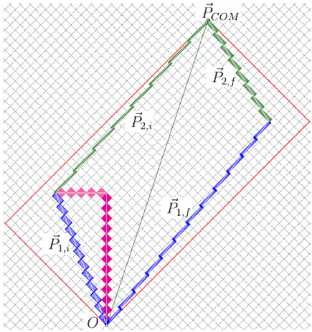

robphy said:
I’m a proponent of spacetime diagrams… since we often refer to the “spacetime geometry”
Spacetime diagrams should be taught in a kindergarten! Though it should not contain the axes and instead of axes there should be just the world line of an observer.
(Disclaimer: I didn't actually think it through, so it might be a bad idea at the end of the day :) )
Yuras said:
Spacetime diagrams should be taught in a kindergarten! Though it should not contain the ##x## axes and instead of ##t## axes there should be just the world line of an observer.
The inherent problem with removing the axes is that we ultimately have Minkowski geometry represented on Euclidean. You’ll need to at least draw a light coneor two, which I guess is easy enough in Minkowski space.

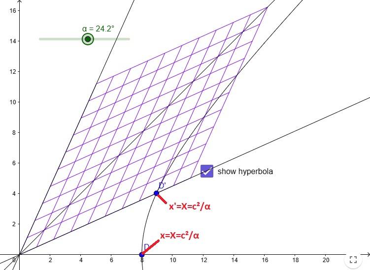

Yuras said:
I remember people (me included) struggling with constantly accelerating observer (the most "complicated" topic most of them ever encounter) until they see the coordinate-free one-liner derivation.
How does this one-liner look like?
I was totally sure I'll find it on wikipedia, but it's not there... Had to come up with something on the fly, so don't expect too much.
Basically you calculate hyperbolic angle (aka rapidity) between the initial 4-velocity and the current one . Start with their inner product and differentiate it by the proper time:
The last step is analogous to (note that and are orthogonal). I don't know hyperbolic trigonometry enough to justify it right now, so I'm hand waving here, but in practice you of course just calculate in the reference frame of :
It's a bit of a cheating, but the statement itself is coordinate independent anyway.
One way or another, after cancelling we get the following:
If the (magnitude of the) 4-acceleration is constant, then we just have uniform hyperbolic rotation, i.e. a hyperbola.
Note that this method handles variable acceleration as long as it stays in the same plane as and . For more general case you have to stop before the last step:
(I really hope I didn't make any silly mistake, and all the above actually makes sense :) )

Yuras said:
One way or another, after cancelling ##sinh## we get the following:
$$\dot w = |\dot u|$$
Yes, this is trivially correct. The hyperbolic angle is times the elapsed proper time of the Rindler observer along the hyperbola via definition of the hyperbolic angle. Therefore .

Source:
http://www.faculty.luther.edu/~macdonal/EGR/EGR.html
I think is is important to teach the Minkowski metric. I see no good reason to remove it and the related definition of TD i.e. from the following paper.
Sorry, but I don't understand your point. I suggested to drop the axis, not metric.
Most likely I'm just misreading your comment, but are you implying that metric tensor is somehow related to coordinates? The whole point of dropping the axis is to prevent students from picking up such misconceptions.
Yuras said:
Yeah, it's useful only for very basic things (aka almost never)
Here are some non-basic situations where a diagram is quite useful.
No, I do not refer to the metric tensor alone. My above screenshot shows the product of the metric tensor with the squared differences-position 4-vector. It results in the (squared) norm of the differences-position 4-vector. Squared coordinate differences are shown.
See also:
Source:
These are great diagrams!
But "basic" is a subjective term. Your examples are exercises, very useful for studding, while practical problems are too messy to draw, harder to interpret graphically (e.g. 4D) and easier to handle algebraically. That's my limited experience anyway.
Sorry, probably I'm just too tired right now, but I don't see your point. Let's hope someone will jump in and address it.
The examples provide explanations, both physical and geometrical.
Some with nice numbers so that one can focus on the physics, and less on the arithmetic.
By "practical problems", do you mean not-necessarily nice numbers?
Sure... once one understands the physics and the underlying math, then one can use the formulaic approaches.
The problem for the beginner is that, in my opinion,
the heavy-formulaic approaches are too detached from the physics and the geometry.
Try doing a euclidean geometry problem or analyzing a block on an incline
algebraically or formulaically alone (that is, without drawing an associated diagram).
