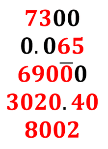

From https://en.wikipedia.org/wiki/Significant_figures
Wikipedia said:
Digits in red are significant figures; those in black are not

The inset from Wikipedia is not very informative as shown because it leads one to believe that the sig figs can be determined simply by looking at the number. Is the number quoted by OP 20 or 20? That's the ambiguity mentioned by @PeroK.
Wikipedia correctly points out "Zeros to the right of the significant figures are significant if and only if they are justified by the precision of their derivation." Simply writing down a 2 followed by a 0 says nothing about the precision of the derivation and is inherently ambiguous.

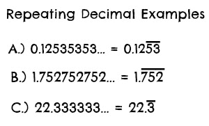

I like the Wikipedia article, but I was also a bit confused when I saw the overbar notation being used in this context. I guess it must be a standard notation for significant digits and marking the zeros?
But when I first saw it, my mind immediately went to "repeating digits" notation, which sent me way off into the weeds... o0)
https://study.com/cimages/multimages/16/repeating_decimals_examples_1.jpg
