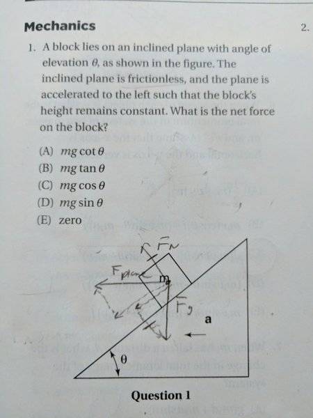

A block lies on an inclined plane with an angle of elevation theta. The inclined plane is frictionless, and the plane is accelerated to the left such that the block's height remains constant. What is the net force on the block?
I'm having trouble figuring out how to draw the correct force diagram for this. When you decompose both gravity and the force from the moving plane, is there ever a force up the ramp that balances out of the force down the ramp due to gravity?
mass, acceleration of inclined plane, theta
the answer is in terms of these variables
F = ma
Fblock = mg
Fparallel = mgsintheta
Fperpendicular = mgcostheta
I know that the force of gravity needs to be balanced out but an upward force. But I don't know where is should be coming from. The only two forces here are gravity and force from the inclined plane.

I tried drawing it here, but it has to be wrong because the block should have a force upwards to counteract gravity.
Your Fplane is way too long. There are two forces acting on the block (1) Gravity straight down and (2) Incline force, perpendicular to the incline because there is no friction. The incline force has two components (a) a vertical component that balances the weight and (b) a horizontal component that provides the acceleration a.
See how it works?
On edit: After seeing the original question, I see that the acceleration is not a given quantity. Your original post implied that it was, that is why I went through the "glued" block argument. Obviously, if the acceleration is given, then the net force is just mass times acceleration.
Oh, so is my mistake the direction of the inclined plane force? While I drew it to be completely horizontal, the force of the inclined plane on the block is actually perpendicular to the inclined plane's surface?
It's kind of hard for me to understand why that is the case. Since the acceleration is to the left, wouldn't ever point on the plane have a force pushing to the left on the block as well? And where is the part that counteracts the parallel component of gravity?
Please reread post #6. Then redraw your diagram with only two forces, gravity mg and incline FN. Draw conventional xy axes along the horizontal and vertical. Note that gravity has only a negative y-component but FN has both x and y components. Apply Newton's second law in both x and y directions.
Perhaps you have missed the point that the incline force is a contact force which means that it adjusts itself to provide the observed acceleration. Here it must be perpendicular to the incline because we are told there is no friction. Only its length can be adjusted not, its direction. You need to adjust its length so that the weight is balanced by its vertical component. Once that is done, the horizontal component is the net force on the block responsible for the horizontal acceleration.
Yeah, under the assumption that it is perpendicular, the problem makes sense and I understand how to finish it. The answer key always had the correct force diagram so I know what it looks like, I just drew mine to emphasize my thought process.
Can you elaborate on: "Here it must be perpendicular to the incline because we are told there is no friction."
Your explanation of how FN adjusts itself to create the acceleration makes sense, but I still don't see how it being frictionless implies a perpendicular force.

A surface generates a single force on a mass placed on it. That single force can be resolved into two components, one perpendicular and one parallel to the surface. The component perpendicular to the surface is also called the normal force . The component parallel to the surface is also called the friction force . They are components, not separate entities. When a surface is "frictionless" that's another way of saying that it is unable to exert a force parallel to its surface so all that's left is the perpendicular component.
Also, is the magnitude of FN a sum of the component of gravity and Fincline?
As I just said, FN is a component of Fincline.
... but I'm still uneasy about the fact that there doesn't seem to be a force parallel to the ramp, pointing upwards.
It's a bad idea to create non-existent forces. There are two objects interacting with the block, Earth and Incline. Once you draw and correctly take these into account, that's all there is.

Suppose you place a small book on top of a large book on a table and you push with your hand only on the large book. Both books will accelerate forward. What force accelerates the small book? Answer: The force of static friction coming from the large book. It is in the forward direction because that is what is needed to provide the observed (forward) acceleration. Static friction does not necessarily oppose the motion, but kinetic friction does. It's a subtle point that is often glossed over by the crass generalization that "Friction always opposes motion."
True, but what makes Ffriction the same as Fparallel of the plane? Both forces do act in the same direction, but that doesn't mean that they are the same force. Yes, Ffriction is 0 because the coefficient of friction is 0, but that doesn't imply the force of the parallel component is zero. If a force pushed horizontally on that small book, even though there is no friction, the small book would still be accelerated right?
It seems you are still confused. Consider the small book lying on top of the large one. The only objects that can exert a force on the small book are the Earth and the large book. The Earth can only exert a vertical force so it cannot accelerate the small book in the horizontal direction. Therefore, it is the horizontal component of the large book force that accelerates the small book. That horizontal component is parallel to the book's surface, therefore it can legitimately be called "static friction." Other than the large book there is nothing else that can exert a horizontal force on the small book.
Ohhh, I was always under the assumption that once you decompose the force vector, its decomposed vectors must exist as a force acting on the block.
So what you mean is: A surface moving along its own direction underneath another object, cannot possibly exist a force on that object due to the lack of friction. Thus, in the case where it is tilted, part of its movement is sliding along the bottom surface of the block, but that force doesn't move the block. Part of its movement pushes out from the surface, and that force pushes the object left and upwards. That force is FN so the net force is finding FNsintheta. and FNcostheta = mg, since it is balanced in y direction.
So mg/costheta * sintheta = mg tan theta = net forceThank you for explaining
