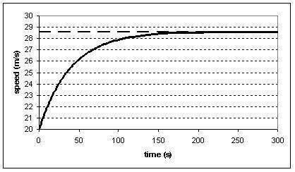

I've seen your https://www.physicsforums.com/showthread.php?t=391600" and I can see you have a problem with power. So let's look at a real problem, step by step.
Find the power needed for the vehicle with the following:
[tex]\rho[/tex] = 1.22 kg/m³
[tex]C_d[/tex] = 0.35
[tex]A[/tex] = 2 m²
[tex]\left( \frac{1}{2}\rho C_d A = 0.427 \: kg/m \right)[/tex]
[tex]m[/tex] = 1500 kg
[tex]v[/tex] = 20 m/s
The power is:
[tex]P = \frac{1}{2}\rho C_d A v^{3} = 0.427 (20)^{3}= 3416 \: W[/tex]
So, to maintain a constant speed of 20 m/s, that vehicle needs to develop 3416 W.
Now, you decide to press the gas pedal such that your car develops 10000 W. What will be the new speed you will eventually achieve?
[tex]v = \sqrt[3]{\frac{P}{\frac{1}{2}\rho C_d A}}} = \sqrt[3]{\frac{10000}{0.427}} = 28.6 \: m/s[/tex]
This is the new constant speed that you will, eventually, achieve to balance all forces. What you don't seem to understand is what happen in between those 2 events. Let's look at it:
Find the acceleration just after you pressed the gas pedal:
[tex]a=\frac{P}{mv}-\frac{\frac{1}{2}\rho C_d Av^2}{m}}=\frac{10000}{1500 (20)}-\frac{0.427(20)^2}{1500}} = 0.22 \: m/s^2[/tex]
This means that for each second, your speed will increase 0.22 m/s. Hence, after 1 second, your new speed will be 20.22 m/s. Finding your new acceleration:
[tex]a=\frac{P}{mv}-\frac{\frac{1}{2}\rho C_d Av^2}{m}}=\frac{10000}{1500 (20.22)}-\frac{0.427(20.22)^2}{1500}} = 0.21 \: m/s^2[/tex]
Thus, after the 2nd second, your speed will be 20.22 + 0.21 = 20.43 m/s
Repeating with the new value for speed:
[tex]a=\frac{P}{mv}-\frac{\frac{1}{2}\rho C_d Av^2}{m}}=\frac{10000}{1500 (20.43)}-\frac{0.427(20.43)^2}{1500}} = 0.208 \: m/s^2[/tex]
And so on. This will give the following graph:
You can see that it will take you around 200 s before you can achieve your new terminal velocity of 28.6 m/s.
