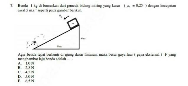

A box slides down with initial V, force needed to stop it?
In summary: For this problem, 10 m/s^2 should be used.In summary, to stop a block at the bottom of a slope, an external force of 5.25 N is needed.
Hilmy atha
Vo = 5m/s
W to the left = 6N
Ffriction = 2N
F to the left = W - Friction = 4 N
m = 1kg
g = 10 m/s^2
Ramp length = 10m
sin a = 3/5
cos a = 4/5
F = ma
Vt ^2 = Vo^2 + 2as
Vt = Vo + at
Outside force (1) to cancel acceleration from weight
= 4N
So now a = 0
Now we calculate how much decceleration is need to stop the initial 5m/s
Vt ^2 = Vo ^2 + 2as
0 = 25 + 20a
a = 1,25 decceleratiom from outside force (2)
F2 = m.a = 1.25 N
So F1(to cancel initail acceleration) + F2(to cancel initial velocity) = 4 + 1.25 = 5.25N
Is there something wrong? The answer is not in the options :/

Okay i updated it
Can you provide a translation of the problem statement? It's not obvious how long the force is allowed to operate on the block. Is it applied during the entire motion?
Hilmy atha said:
F2 = m.a = 1.25 N
So you need 4 N (in addition to the 2 N friction force) to counter the down-the-slope weight component.
And you need 1.25 N to produce an up-the-slope acceleration.
4 + 1.25 = 5.25 N.
I can't find anything wrong with that. But it is early in the morning for me. :)
Possibly the problem creator had a sign error and came up with 4 - 1.25 = 2.75 (which rounds to 2.8)
In response go @gneill comment (which just came through), I assumed the force was applied for the entire 10 m of the slope.
It is not mentioned at all. Everything i typed is basically the translation in math equations
I typed the words into Google translate and the relevant part of the translation was:
"so that the right thing stopping at the bottom end of the track"
Per my previous post, I think your answer is correct.

Your answer may end up closer to 5.0 N if you use a more accurate value for g.
