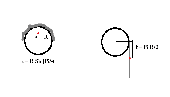

So, I've created this horrible drawing to try an illustrate what I'm thinking. The red dots symbolize the CM of the chain, and the constants a and b represent the vertical distance from the center of the disc to the CM of the chain:
So in this case, Δh = a + b = R(π/2 + 1/√2)

Looks good except I disagree with "a"
Where would you put the center of mass of the chain, as it was resting on the wheel? (if not at a)
I agree with your idea, I just disagree with your value of a.
Can you show the calculation that led to the value of a?
Half of the mass of the chain corresponds to half the length. Half of the length is from Pi/4 to 3Pi/4, measured from 0 being on the horizontal axis. Therefore, the height that splits the mass of the chain vertically would be R Sin [Pi/4]. If you drew a horizontal line at this height, half of the chain's mass is above, and half is below.
That's an interesting idea, but that's not how the center of mass works. It's not about having half the mass on one side and half on the other side, it's about "weighing" the mass by it's distance from the axis. (More specifically, [itex]y_{CoM}=\int ydm[/itex])
What if we were to deform the top half of the semi circle so that half of the mass is still above 1/√2 like in this picture:
http://postimg.org/image/gnbx3qra7/
Wouldn't you expect that the center of mass would change? But according to your method the center of mass does not change.
Ah, good point...
Ok, so Rcm = (1/M) ∫(vector r) dM
M= λ L
dM = λ dL = λ R dφ
Vector r = R rhat = R Cosφ x_hat + R Sinφ y_hat
Plugging this into the integral and solving in terms of known constants yields:
Rcm = (2R/π) y_hat
So you are absolutely right, it's less high than I had originally thought.
Adoniram said:
Rcm = (2R/π) y_hat
With that fixed, I agree with your answer for ω :smile:
