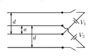

1. Two identical flat plate capacitors are inserted in each other. First, none of the plates was charged, but then they have been connected to sources of current, keeping the constant voltage ## V_1 ## and ##V_2 ##. Find the potential difference between inner plates, which are kept at the distance a one to another. The distance between the capacitor plates is d.
2. ## -gradφ=E ##
## E=\frac σ ε_0 ##
##∫Edl=0## (over a closed loop)3. I tried to solve this problem in many ways. For instance, I tried writing the electric field intensity E and making use of the circulation theorem, supposing that the plates are mutually inducing the same surface charge distribution σ, but I got a weird result. I tried to write the potential of each plate as electric field intensity multiplied by the distance between the plates, but I did not get a satisfying result. I am clueless what to do next and I don't know what is wrong in my approach.

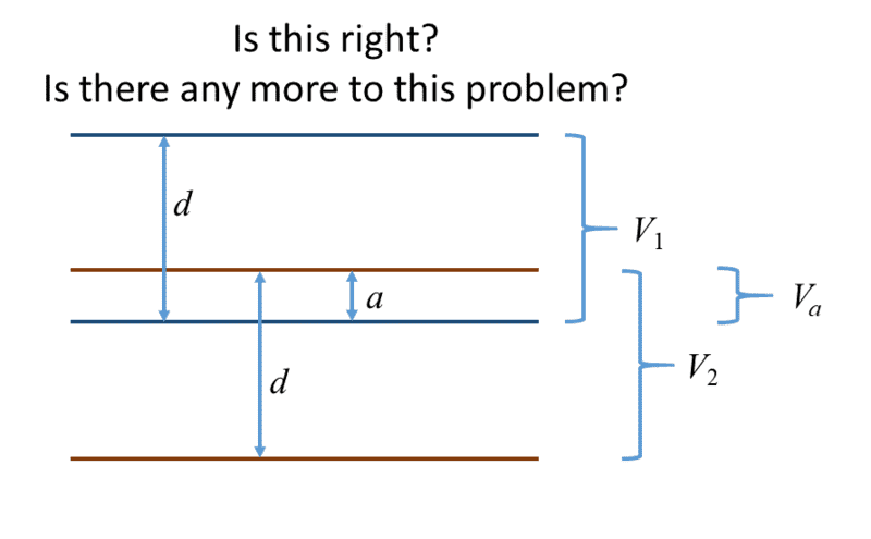

I'm not totally sure I understand the configuration. But the way I presently understand it, the physical configuration is as in the figure below,
where [itex] V_a [/itex] is the electric potential that we are looking for. But I've pretty much convinced myself that unless there's some additional constraint that I'm missing, or unless I'm not understanding the problem in some other way, that there is not a unique solution to this problem.
[Edit: an example of an "additional constraint" might be something like [itex] V_1 [/itex] and [itex] V_2 [/itex] sharing a common ground, or anything of that nature. But the way it is now (as I presently understand the problem), [itex] V_a [/itex] is unconstrained.]
[Second edit: see my next post. I think there is a way out of this.]
I think there is a way out of this. I think it comes down to the part of the problem statement that says, "First, none of the plates was charged, but then they have been connected to sources of current, ..."
I think from that, we can take that initially all plates were equipotential. And after that point on we can infer that the only variations were changing charge distributions differentially on plates of a given capacitor, but not between the two capacitors (i.e., not overall from one capacitor to another). That should be enough to solve this problem.

The inner plates of the two capacitors A(red) an B(blue) can be split, and then we have a chain of three capacitors, C1, C2, C3, with charges q1, q2, q3. The two plates of each original capacitors have equal and opposite charges, as @haruspex suggested, (QA and -QA, QB and -QB) which are distributed between the virtual plates of the new capacitors. See figure.
We can write up the loop equations and also the relation for the charges:
U1-q1/C1-q3/C3=0
U2-q3/C3-q2/C2=0 (Edited)
q3-q2-q1=0
The system of equation is easy to solve.

@ehild, do you care to give a brief explanation of why the two circuits you display are equivalent? I don't understand your intuition behind it, how come you thought of introducing a third new capacitor?
You have four parallel plates of the same area and certain distances between each pair of plates. Is not it three capacitors connected? It will be the same three capacitors if you split each plate and connect the parts with a short wire: The pairs will be equipotential with the original plate.

An equipotential plane can be replaced with a thin conducting plate. Then surface charge builds up on both surfaces, according to the electric field.
In case of the capacitors in the problem, each plate have some surface charge on both sides. Splitting the plate, the new plates have charge according to these surface charges.
The method is also applied with such problems "fill a parallel plate capacitor half to the distance between the plates with some dielectric. What is the new capacitance? " Here we replace the capacitor with two connected ones, one with dielectric, then other without it.
