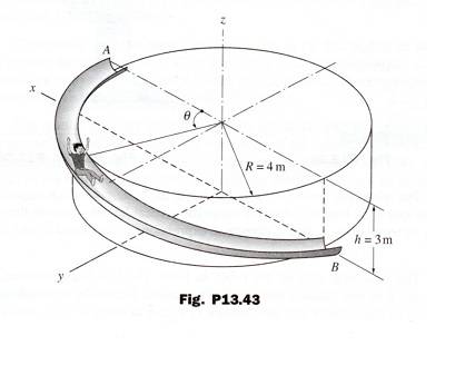

13.43 A child slides down the helical water slide AB. The description of motion in cylindrical coordinates is
##R=4m##, ##θ=ω^2t^2## and ##z=h[1-(\frac {ω^2t^2} {π})]##, where h=3m and ω=0.75rad/s.
Compute the magnitudes of the velocity vector and acceleration vector when the child is at B.

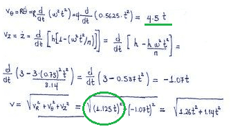

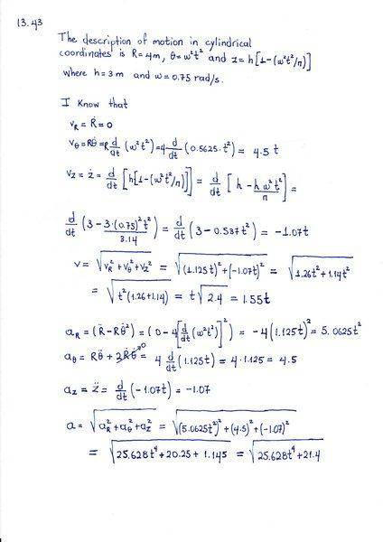

Is this correct?
Yes, this looks right. You just need to find the value of ##t## at point ##B## to get a number.

Is this possible to find t with the given data? or is it ok to leave it as it is?
Yes, this is possible since you know the change in ##z##.
Looks like a maybe a slip when substituting for ##v_{\theta}##.
It's often a good idea to work things out in symbols and then plug in numbers at the very end.
TSny said:
Looks like a maybe a slip when substituting for vθ
After correction v becomes 4.62t
NFuller said:
Yes, this is possible since you know the change in zzz.
At first I couldn't figure this out but then I realized that the child is sliding down the slide. This means that if we accept as the z positive direction
is upwards then the formula becomes:
##z=h[1- (\frac{ω^2t^2} {π})] => -3=3-0537t^2 => t=3.34s##
So ##v=4.62t=15.43 m/s##
and ##a=56.66 m/s^2##
Am I correct?
I think so, so long as there aren't any other arithmetic errors I missed.
