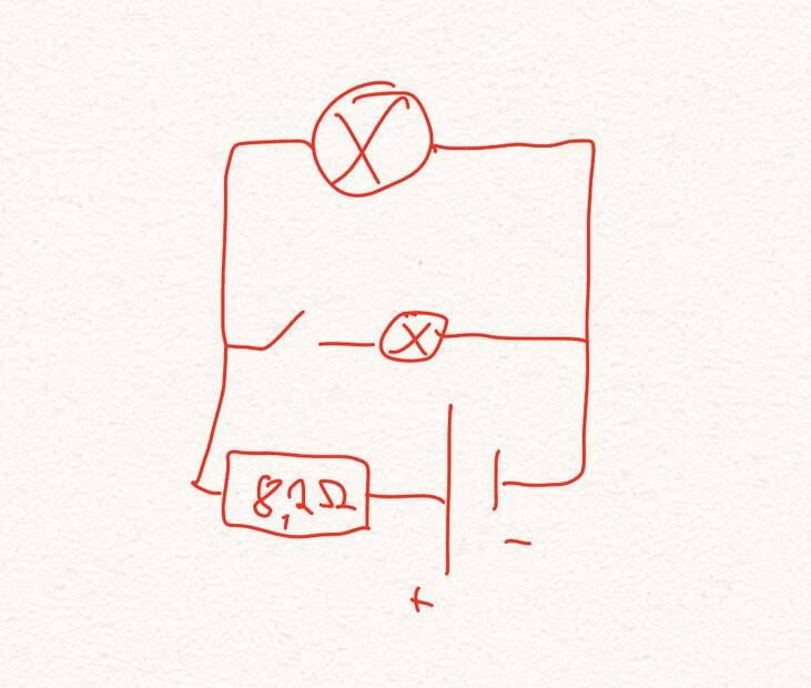

Ok, this is a problem from our textbook and I really do not know how to approach this one, I searched the interned a could not find something similar. I cannot just use Ohm’s Law because the resistor is changing in value. Any help would be appreciated :).
U = I * R
In the circuit, two identical incandescent lamps are connected to a voltage source of voltage U = 6.0 V via an ohmic resistor of magnitude
R= 8.2 are connected to a voltage source of voltage U = 6.0 V.
As electrical components, incandescent lamps do not behave like ohmic resistors. When current flows through a lamp, it heats up and changes its electrical resistance. The table gives the current 1 flowing through an incandescent lamp for the incandescent lamps used, at various voltages U dropped across the lamp.
2.a) Determine the amperage / of the current flowing through the resistor when the switch is open.
2.b) Determine how high the voltage of the battery must be so that a current of the same intensity / flows through the resistor when the switch is closed.
current of the same amperage / flows through the resistor.

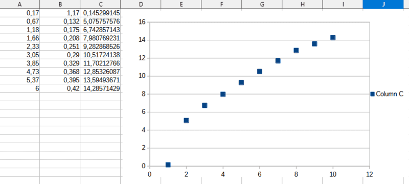

I thought about this, if I plot it I can see that it is rapidly increasing. I just don’t know how to calculate the voltage after the first resistor. Thanks for the reply :)
I would still stay with the Excel spreadsheet to calculate the first operating point. After you add the column for the resistance as a function of voltage, maybe make a new table that calculates the resistor voltage divider numbers. Can you give that a try?
I am not the best with Excel..

What does the plot in post #6 show? I can guess that the vertical axis is (V/I) but I cannot guess what the horizontal axis is. Please add labels to your axes and repost or edit post #6. Also the first point in that plot is too low. Please check it.

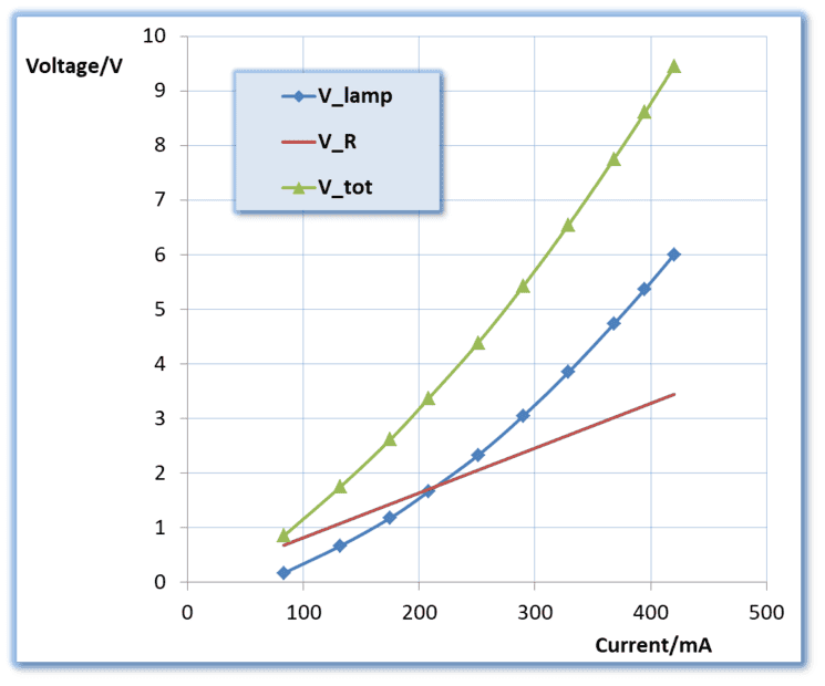

The following approach is relatively simple/quick and (I think) hasn’t been suggested yet. For question 2.a) ...
Consider, for example, the data point when the pd across a lamp is 0.67V and the current through it is 0.132A. If this were the operating point, the pd across the resistor would be IR = 0.132*8.2 = 1.0824V. The total pd ##U_{tot}## across the lamp and resistor would be 0.67 + 1.0824 = 1.7524V.
Similarly find ##U_{tot}## for other data points.
Plot total ##U_{tot}## against current.
At the required operating point, ##U_{tot}## equals the supply voltage (6.0V). Just read the current off the graph.
(In fact you probably don’t need a graph; simple linear interpolation might be adequate. And you don’t really need to find ##U_{tot}## for all data points. So the problem can be solved pretty quickly.)
