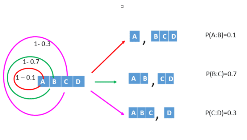

I've a small molecule ABCD made of building blocks A,B,C,D. The molecule can get cleaved at any 'bond' between the building block one bond at a time.
Researchers have compiled probabilities from dissociation studies of large number of molecules( made up of many other building blocks) and the dissociation probs are as follows say:
A:B = 0.1, B:C = 0.7, C:D = 0.3
So, when the bond between A-B breaks, I get a FRAGMENT PAIR with some prob (0.1) plus the molecule ABCD has some prob. 1-0.1 = 0.9 to remain undissociated.
However, as these probs are derived from a large dataset I've to normalize the probabilities so that, the sum of the probabilities of the exhaustive events becomes one for my case.
Hence,
the normalizing constant (k) would follow:
k * ( 0.1 + (1-0.1) + 0.7 + (1- 0.7) + 0.3 + ( 1- 0.3) ) = 1.0
or, k * 3 = 1.0
or, k = 1/3 = 0.33
So. the normalized probs of fragment pairs
p(A, BCD) = 0.1 * 0.33 =0.033
p(AB, CD) = 0.7 * 0.33 = 0.231
p(ABC, D) = 0.3 * 0.33 = 0.099
and the total prob. of ABCD to remain un-fragmented = (1-0.1) *0.33 + (1-0.7) * 0.33 + (1-0.3) *0.33 = 0.297 + 0.099 + 0.231 = 0.627
Am I doing it right?
Thanks
I'm not sure I understand the data. Does that diagram come with the question?

The scenario is this: we start with a large number of molecules of ABCD. After a certain time, some of the molecules have split into two molecules A + BCD; some have split into AB + CD; some have split into ABC + D; and some have not split and remain ABCD. Each of these processes has a certain probability:
There is a probability ##p_0## that the molecule stays as ABCD. Is ##p_0 = 0.9##? Or is ##p_0 = 0.1##? Or is ##p_0## something else? It's not clear from what you've written what all these numbers mean.
There are probabilities ##p_1, p_2, p_3## that the molecule splits into A + BCD, AB + CD, ABC + D. It's not at all clear what these probabilities are. They cannot be 0.1, 0.7 and 0.3, as these add up to 1.1. What do these numbers (0.1, 0.7, 0.3) mean?
I'm sorry that I can make no sense of what you are trying to do.

The way I read that the probs are independent.
So we end up with
ABCD (1-.1)(1-.7)(1-.3)
A|BCD (.1)(1-.7)(1-.3)
AB|CD (1-.1)(.7)(1-.3)
ABC|D (1-.1)(1-.7)(.3)
A|B|CD (.1)(.7)(1-.3)
A|BC|D (.1)(1-.7)(.3)
A|B|C|D (.1)(.7)(.3)
