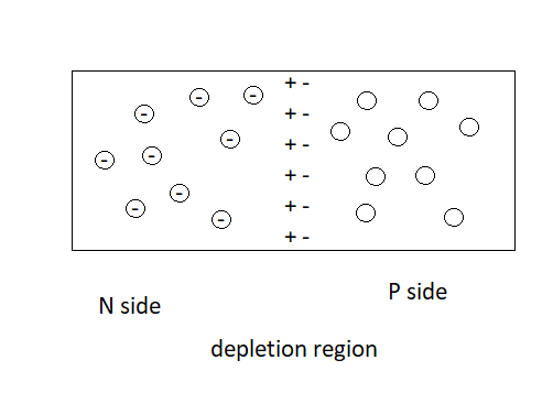

In a diode, we have N side, P side, and a depletion region, made of positive and negative charged sides. N side and P side of the diodes are neutral charge.
In N side there are free electrons. In the positive charged side of the depletion region, there are positively ionized atoms that "lack" electrons.Why the free electrons at the N side don't get "pulled" to the positive charged part of the depletion region, and neutralize the ionized atoms there?
Or why electrons at the N side don't get pulled by the positive charge of the depletion region?
And in the sunar collectors, how does the "depletion region" causes the "free electrons" on the P side move from P-side to the N-side, when there's a "barrier" of negative charge in the "depletion region" that would push the electrons back to the P side?

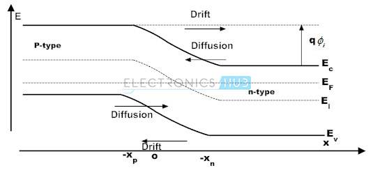

Look at the band diagram in the depletion zone:
Notice the band-bending. Now, these are equivalent to the "potential energy" curves versus position. Dig back from your E&M class and recall that dV/dx has a significance (hint: it is equivalent to the electric field).
So if the bend bending causes the presence of a built-in electric field in the depletion zone, what do you think will maintain the separation between the positive and negative charge carriers?

How does that band bending cause electric field in the depletion zone?
How does a gradient in the potential field causes an electric field?

What I only understood from the diagram is that the conduction band is lower in the N side than in the P side. So in the N side more electrons are in the conduction band, thus are "free" to move.

The "bend bending" is due to the different "energy levels" of the conduction and valence band in n-type semiconductor and p-type semiconductor. When there is a gradient in the energy band (i.e. the slope of E versus distance is not zero), then there is a "net force" built in due to the contact potential difference between the two material. This is the "culprit" that forces the majority charge carrier of one type to go to one side, while the other type to go to the opposite side. This bend-bending is the SOURCE, the explanation, and the origin, of these charges being pushed to one side. This was why I was asking if you know what a gradient in the potential field leads to.
You will need to learn about band diagram of semiconductors (intrinsic and extrinsic) if you want to know more about how these bands come about.

As I know when electrons get energy and excited, they can move from valence band to the conductive band. Electrons at the conductive band are "free". More such "free" electrons in a matter causes the matter to be more "conductive", also easier to move charge through the matter. There are more such "free electrons" in metals than in plastics.
In the pictre above, above Ec is the conductive band, and below Ev is the valence band.
The diagram above shows that the "conductive band" and "valence band" is lower in the N side of the semiconductor than in the P side. That means it requires less energy to get an electron "excited" and move from valence band to the conductive band. And this means there are more free electrons in the N side than in the P side.
This band bending causes the charges being pushed to one side. But how does this band bending cuase charges, electrons and holes, pushed to one or other side?
