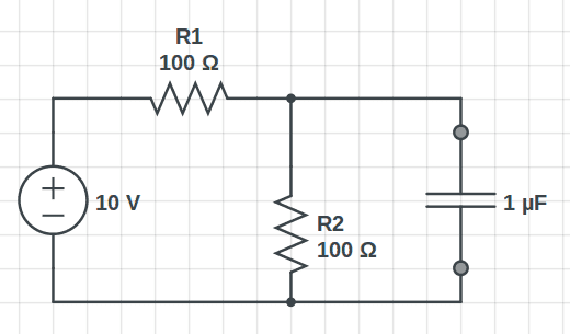

Lets say I have a DC voltage source in series with two resistors. R1 and R2. Now let's put that capacitor in parallel with R2. Your capacitor will NOT be equal to the voltage source in steady state. However, it will be equal to the voltage across R2. (parallel).
Picture the same scenario, but add an R3 in series with the capacitor. The cap voltage will still equal
R2 voltage...and R3 will equal zero voltage in steady state again because there is no current thru resistor R3, therefore no voltage drop.
Clear?
And what will the voltage across R2 be equal to? Wouldn't it be equal to the voltage source since there is no voltage drop across R1?
So VR2 and the capacitor's voltage would equal 10V? No, that doesn't seem right.

So R1 and R3 have 0 voltage and VR2=Vcapacitor=10V?
IN your first picture the voltage across R1 is 5 volts, R2 is 5 volts...and since cap is in parrallel, cap voltage is 5 volts. In this circuit, current flows freely thru R1 and R2...no current thru cap, just voltage.
In your 2nd picture, you did not draw what I described. R3 needs to be in same branch with cap...R3 in series with capacitor. Just flip it over to the right side of R2.
I would suggest mastering this stuff first before you move on to transient equations. Building your foundation is key before moving on. So keep asking until its crystal clear.

Ah, I completely get it now. So for the 2nd picture with R3 in series with the cap (after the diagram is fixed), the voltage of R2 and the cap is 5V, right?
Yes sir.
This doesn't look right at all or perhaps we are discussing a different diagram. You have three 100Ω resistors in series so the steady state volts across each one will eventually be 10/3V. At switch on, the voltage across the capacitor (and R2) will be zero and there will be 5V across R1 ands R3
Right, different diagram. If you re-read post #8, he has the circuit drawn differently then I described.
OK, that's resolved that then. :smile:
It's a good idea to draw circuit diagrams out, explicitly, when possible.
