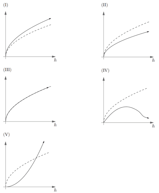

A snow cylinder rolls down a hill, gathering snow that increases its radius, and the discussion centers on calculating its speed while considering energy conservation. The initial consensus is that the speed remains unaffected by the changing radius, leading to the conclusion that Graph III represents the speed if the snow sticks. However, doubts arise regarding this reasoning, as the snow's inertia affects the cylinder's acceleration, suggesting that the snow-gathering cylinder (SGC) would have a lower speed compared to a fixed-radius cylinder (FRC). The argument is made that the SGC experiences a decelerating torque due to the snow it picks up, which contradicts the initial conclusion. Ultimately, the discussion highlights the complexities of energy conservation in this scenario and the need for a more nuanced understanding of the mechanics involved.
guv
122
##mgh = \frac{1}{2} mv^2 + \frac{1}{2} I \omega^2##
A snow cylinder with an initial radius ##R## rolls without slipping down a tall hill with constant slope. As
it rolls, snow sticks onto the cylinder which makes its radius slowly increase. The amount of gathered
snow is proportional to the distance the snow cylinder has traveled. Consider the following graphs
which represent arbitrary units on the ##y##-axis which will be specified according to the problem. (Note:
For graph III, the arrow lies directly on top of the dotted line).
If the dotted line represents the speed of the cylinder if the snow was not sticky, which of the following
graphs represents the speed of the cylinder if the snow sticks to the cylinder, as described above?
The answer says it's Graph III and gives the following explanation,
ince the object is rolling without slipping, we have the relationship ##v = \omega r##. Applying energy conservation allows us to write that
##mgh = \frac{1}{2} mv^2 + \frac{1}{2} I \omega^2 = \frac{1}{2} mv^2 + \frac{1}{2} \beta m R^2 (\frac{v}{r})^2 ##
##v \propto \sqrt{h}##
From this analysis, it is evident that the changing radius of the cylinder does not actually effect
the velocity it rolls down with.
I have some doubt about the given answer. We know that the CM speed is only dependent on the geometry of the object, let the rotational inertia be ##I = \beta m R^2##, for cylinder ##\beta = \frac{1}{2}##, for a ring it's ##\beta = 1##.
Now we can think of the original cylinder having ##\beta = \frac{1}{2}##, if snow does not stick to the cylinder, the final CM speed is
##v = \sqrt{ \frac{2 H}{g (1 + \beta)}} = \sqrt{ \frac{4 H}{3g }}##
If the snow sticks to the cylinder without slipping, we can consider the snow form rings on the cylinder whose ##\beta = 1##. This should change the overall rotational inertia of the snow object and slows it down.

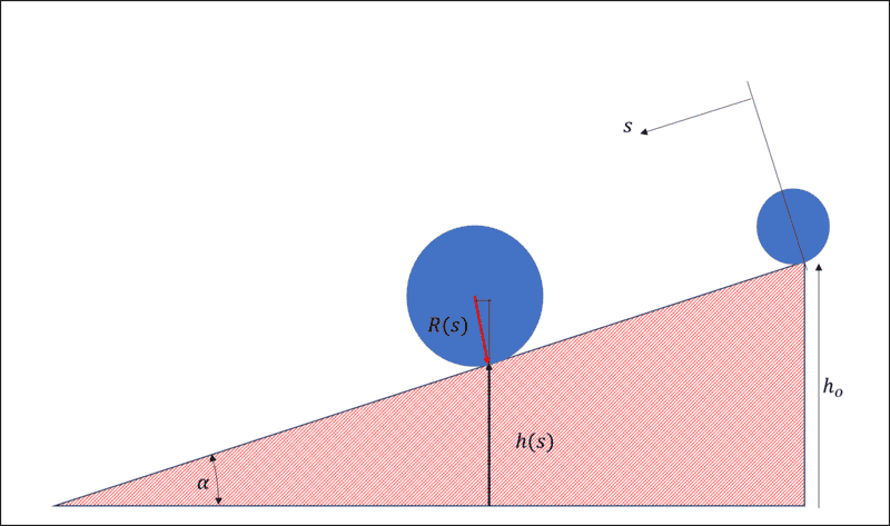

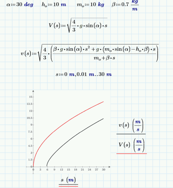

If we ignore that the center of mass is not traveling parallel to the slope as a simplification, I think you want to try to re-express conservation of energy as:
$$ m_o g h_o = \frac{1}{2} m(s) v(s)^2 + \frac{1}{2}I(s) \omega (s)^2 + m(s) g h(s) $$
where ##s## is the coordinate originating at the top of the slope, parallel to the slope.
At least that is what I would try, maybe I'm missing something...

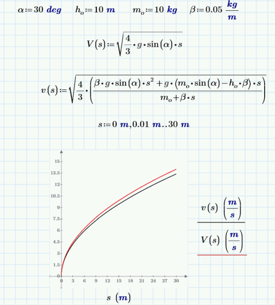

Yeah I figured I missed something ( I always do). I plotted it and there appears to be some funny business that maybe is explained by what you mention. Dependencies on initial height of the mass, the initial mass ect... Anyhow the for a certain set of parameters there appears to be a maximum ##\beta##, you can vary the parameters to get it back in line, but I agree that its goofy. Here are a couple plots:
Notice the funny business in the last plot where ##\beta## in increased to ##0.7 \rm{\frac{kg}{m}}##. The numerator is going negative there in until ##s## increases to a certain value ( as far as I can tell ). Thats telling me that for a certain ##\beta## and set of inital conditions, it wont even start rolling, that can't be correct...
Back to the drawing board.

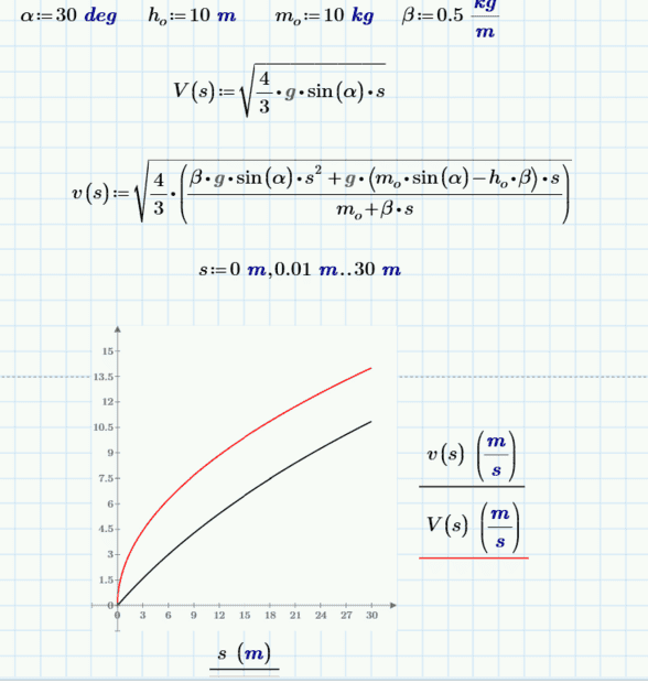

I was using this for the angular term:
$$ \frac{1}{2} I(s) \omega (s)^2 = \frac{1}{2}\left( \frac{1}{2} m(s) R(s)^2 \right) \left( \frac{v(s)}{R(s)}\right)^2 = \frac{1}{4} m(s) v(s)^2 = \frac{1}{4} \left( m_o + \beta s \right) v(s)^2 $$

The way I have it set up the center of mass as the radius grows would follow ##h(s) + R(s) \cos \alpha## is what I'm thinking, so the PE of the ball and all the snow its picked up would be at position ##s##:
$$ PE(s) = m(s) g \left( h(s)+R(s) \cos \alpha \right) $$
Does that account for the PE of the picked up snow laying on the ramp? I was initially ignoring that, maybe that is the source of the unexpected behavior in post #6. I probably work it in later, and redo the plots.

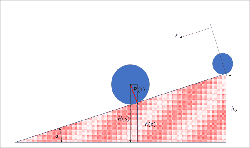

Wait a bit. You are taking the height of the snow, ##h(s)## and not multiplying it by ##\cos \alpha## and then taking the radius of the snowly cylinder, ##R(s)## and multiplying that by ##\cos \alpha##. Is that not backward?
Worth asking: Where is your zero point for this calculation?
Edit: I think I get half of it. You are using a zero point on the slope where a perpendicular drawn from the center of the cylinder would intersect. That explains that ##\cos \alpha## multiplier on the shell radius. But it does not explain the lack of a factor of ##\cos \alpha## on the height of the snow layer.
It looks like you are trying to compute the potential energy of the snowy shell based on the sum of the height to which the shell is lifted free of the ground by the snow beneath and on the height of the shell's own center of gravity above its bottom edge.
Looking more carefully I think its needs more massaging, because the center of mass is not above ##h(s)##, but that is my general direction.

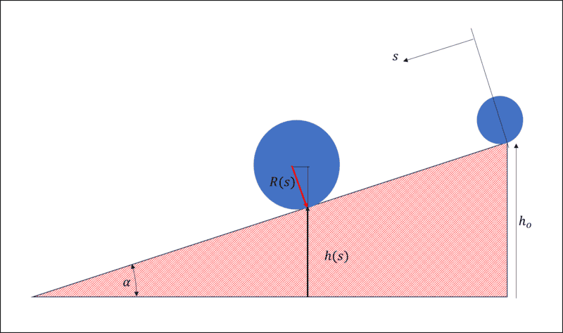

That diagram looks nothing like my mental picture of the situation. The snow makes a layer on the ground, not a triangle. It has a potential energy when laying on the ground. It has a differrent potential energy when wrapped around the cylinder.
However, I do agree with your formula for the potential energy of the snow wrapped around the cylinder now that I understand how you are using ##h(s)##
The triangle is the slope its rolling down. I'm not giving physical dimension to the laying snow, other than its mass. I'm just imagining the cylinder is uniformly accreting mass, and its radius is growing accordingly.
Let me save you future headaches. Any time I present a model it's an introductory physics level of abstraction.
##s## is to the point of tangency. I think that the CM being offset is not much of an issue after all. The height directly under the COM ##H(s)## is equivalent to ##h(s)+ R(s) \cos \alpha ## upon closer inspection.

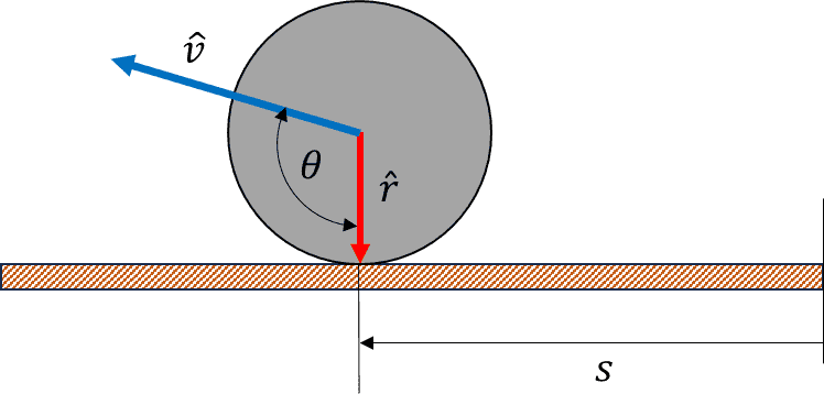

I see another complication in the assumed relation ##v=\omega~r##. It is valid for rolling without slipping but only if the rolling radius is constant. Here is why.
We have the definitions $$s=r~\theta~;~~v=\frac{ds}{dt}~;~~\omega=\frac{d\theta}{dt}$$and from post #7, $$r=\sqrt{\frac{m_0+\beta s}{m_0}}r_0.$$ It follows that $$\begin{align}\omega= & \cancel{\frac{d}{dt}\left(\frac{s}{r}\right)=v\frac{d}{ds}\left(\frac{s}{r}\right)=v\frac{d}{ds}\left[ s\left( \sqrt{\frac{m_0+\beta s}{m_0}}r_0 \right)^{-1} \right] }\nonumber \\
& =\cancel{\frac{v}{r_0} \sqrt{\frac{m_0}{m_0+\beta s}}\left[1-\frac{\beta s}{2(m_0+\beta s)} \right]} \nonumber \\
& =\cancel{ \frac{v}{r} \left[1-\frac{\beta s}{2(m_0+\beta s)} \right]}.
\nonumber \end{align}$$Clearly, ##\omega =v/r## only when ##\beta = 0.##
On edit
This is incorrect. To put it simply, I should have used ##ds=r~d\theta## and then divide by ##dt##. The relation ##v=\omega~r## holds at all times. Sorry about that.
We have the definitions $$s=r~\theta~;~~v=\frac{ds}{dt}~;~~\omega=\frac{d\theta}{dt}$$and from post #7, $$r=\sqrt{\frac{m_0+\beta s}{m_0}}r_0.$$ It follows that $$\begin{align}\omega= & \frac{d}{dt}\left(\frac{s}{r}\right)=v\frac{d}{ds}\left(\frac{s}{r}\right)=v\frac{d}{ds}\left[ s\left( \sqrt{\frac{m_0+\beta s}{m_0}}r_0 \right)^{-1} \right] \nonumber \\
& =\frac{v}{r_0} \sqrt{\frac{m_0}{m_0+\beta s}}\left[1-\frac{\beta s}{2(m_0+\beta s)} \right] \nonumber \\
& = \frac{v}{r} \left[1-\frac{\beta s}{2(m_0+\beta s)} \right] .

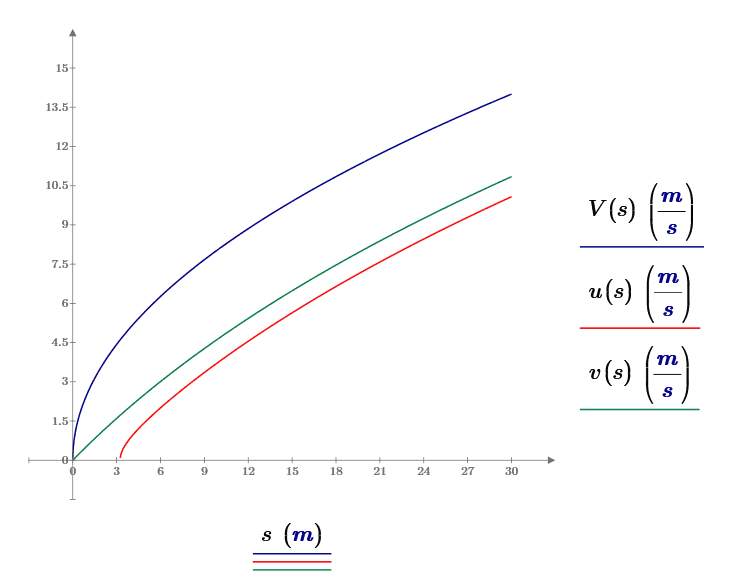

I’m fine with chipping at it a bit. I don’t wan’t to get too bogged down right away such that I completely stall. Re-forming the kinetic energies seems like a problem of its own.
However, if you want to present the full solution, it won’t hurt my feelings. I’ll probably be asking questions to finish it out regardless.

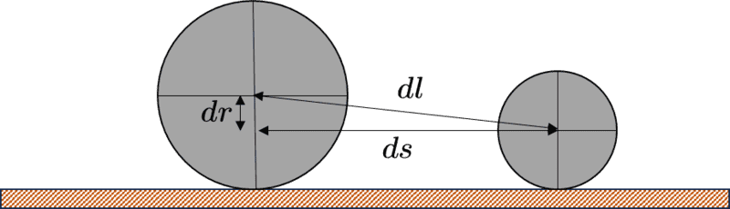

@kuruman well, you put the bug in my head. My thoughts are that the center of mass moves on a curved trajectory:
For the velocity of the center of mass ##\frac{dl}{dt}## I find:
$$ dl^2 = ds^2 + dr^2 $$
$$ \implies \frac{dl}{dt} = \sqrt{ 1 + \left( \frac{dr}{ds} \right)^2 } \frac{ds}{dt} $$
Then for the translational kinetic energy:
$$ KE_{trans.} = \frac{1}{2} m(s) \left( \frac{dl}{dt}\right)^2 =\frac{1}{2} m(s) \left( 1 + \left( \frac{dr}{ds} \right)^2 \right) v(s)^2 $$
Then to get ##\frac{dr}{ds}## we begin with the mass:
$$ \rho \pi L r^2 = \rho \pi L r_o^2 + \beta s $$
$$ \implies 2 \rho \pi L r \frac{dr}{ds} = \beta $$
$$ \implies \frac{dr}{ds} = \frac{\beta}{2 \rho \pi L} \frac{1}{r} $$
Next sub that result into the translational kinetic energy with: ## r^2 = r_o^2 + \frac{\beta}{\rho \pi L} s ##
$$ KE_{trans.} = \frac{1}{2} m(s) \left( 1 + \left( \frac{\beta}{2 \rho \pi L } \right)^2 \frac{1}{ r_o^2 + \frac{\beta}{\rho \pi L} s} \right) v(s)^2 $$
Is this a step in the right direction?

But the center of mass velocity is not collinear with the coordinate velocity. The mass is accreting, the center of mass has two orthogonal components of velocity.
This is in response to the complications @kuruman brings up in #21. I haven't locked down how to tackle those, but in trying to do so this became apparent along the way. If we are worrying about correcting angular kinetic energies, we should correct translational kinetic energy as well?

For the angular velocity at any instant in time if the wheel is not slipping, I can't see how the relationship is invalid?
$$ \hat{v} = \hat{r} \times \hat{\omega} = | \hat{r} | ~ |\hat{\omega}| \sin \theta = r \omega \sin \theta \hat s = v(s) \hat s $$
I think the angular kinetic energy is simply as it was:
$$KE_{rot.} = \frac{1}{4} m(s) v(s)^2 $$
and it was the translational energy that needed to be adjusted?
$$ \hat{v} = \hat{r} \times \hat{\omega} = | \hat{r} | ~ |\hat{\omega}| \sin \theta = r \omega \sin \theta \hat s = v(s) \hat s $$View attachment 329251I think the angular kinetic energy is simply as it was:
Disregard. I think I have some wires crossed in my cross product...
I'm not sure how to fix it formally, but its only the component of ##\hat v ## perpendicular to ##\hat r ## and ##\hat \omega## which contributes to the angular kinetic energy, correct?
I still think the angular energy term is
$$ \frac{1}{4} m(s) v(s)^2 $$
But I can't seem to show what I want formally.

Well my final go would be:
$$ m_o g\left( h_o + r_o \cos (\alpha) \right) = \frac{1}{2} ( m_o + \beta s ) \left( 1 + \left( \frac{\beta}{2 \rho \pi L } \right)^2 \frac{1}{ r_o^2 + \frac{\beta}{\rho \pi L} s} \right) v(s)^2 + \frac{1}{4}( m_o + \beta s )v(s)^2 + ( m_o + \beta s ) g \left( h_o - \sin (\alpha)~ s + \sqrt{ r_o^2+ \frac{\beta}{\pi \rho L} s }~ \cos (\alpha) \right) $$
Its not pretty, but I'll plot ##v(s)## when I get a chance to see if it fixes the issues I found in the last model.

The model doesn't seem to correct the issue with ##\beta## having an upper limit ( in fact it shrinks it). I can't figure out what it means.
Here they are plotted:
