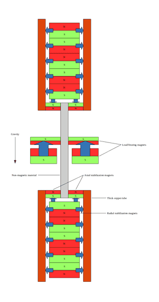

This is what I came up with using your bearing system (side cut, the entire thing is radially symmetric, everything connected to the shaft is spinning, everything else is fixed):
So as per (2) I am guessing this makes the shaft unstable in the up/down direction as it would oscillate up and down with no damping until it hits one of the magnets. Or wouldn't the eddy currents inside the copper tube resist any up/down movement of the tube along the magnets, naturally providing damping, as in the popular "drop magnet in copper tube" demonstration, or does that damping just go into the fixed magnets in the form of heat?

1) Eddy current force calculations are notoriously difficult. You could probably get an order-of-magnitude value from very simplified assumptions, but to do a proper job you really need a multi-physics finite element package (expensive). Since it is so cheap and easy to buy some magnets and give it a spin and get a certain and correct answer, I would take that approach. If you do a search for "electrodynamic bearing" then you should come across the PhD thesis of Torbjörn Lembke which should give you plenty of information and probably even measured restoring forces with various magnets and at different rotation speeds.
2) The diagram you have shown above should work fine. Of course it will need some mechanical bearing surfaces to slide on while it is being spun-up before it self-centres. Earnshaw doesn't apply to either diamagnetism or eddy current repulsion (= strong AC diamagnetism!) and so your longitudinal stabilisation should also work just fine. (From Earnshaw the radial directions would be unstable until you got it spinning) If you have money to spend you could even hire Torbjörn's company magnetal.com to do the design for you! (It is possible that he has some patents on the ideas but I have not seen any mention of such).
I am sure you are correct that axial motion will also be strongly damped by the "drop magnet in copper tube" effect!
Good Luck!
