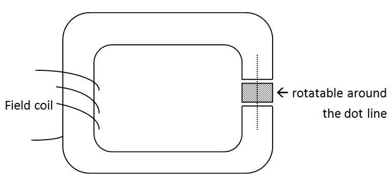

There is a short movable section of cylinder shape in a O-ring magnetic core with DC coil, of course, there are 2 air gaps between the movable section and stator main section. My question: if rotate the movable section, is there a bunch of twisted magnetic lines?
The rotation does not change the outlook of whole O-ring core, so gaps keep same volume.
Can you upload a sketch? I'm having trouble visualizing what you are describing. Use the "Attach files" link below the Edit window to upload a PDF or JPEG copy of your sketch. Thanks.
Thanks for the drawing. If the cylinder is ferrous, the B-field lines from the C-core will just go right through it, with a little fringing at the two air gaps. The cylinder will be in an unstable position, so will need to be supported against thrust in the vertical direction. I don't see anything that will cause the cylinder to rotate about its dotted-line axis that you show.
The field lines will readjust to minimize their path length (i.e. straight) almost instantly. Unless your spinning that think near the speed of light, LOL.
edit: Maybe the worst sentence I ever typed.
Though undrawn in the sketch, I can use a motor to drive the cylinder via belt, of course bearings are needed to keep stable.
Both the stator main section & the rotatable short section are made of same magnetic material, e.g. silicon steel etc.
Are you sure the MagnetoMotive Force (MMF) lines will not twisted within the gaps?
I remember textbooks state there are lots of magnetic domains inside magnetic materials, and MMF lines go through magnetic domains; so if the said section is rotating, then supposedly MMF lines should be twisted.
It seems experiment can be done like this:
scatter some ferrous powder on a hard paper, then insert the paper in a gap, hold at hand, and make sure the paper not touch the stator or the rotor. watch the powder during rotation.
Not test, just by theory imagination now.

The ferrous powder will be attracted to the nearest pole of the C-core. If you want to keep it in place, maybe put it between two microscope glass slides separated by a small 1-2mm spacer around the periphery of the slides. I'm guessing the experiment will not show any movement/drag of the powder between the slides as you rotate the slides in the gap.

Any sort of anisotropy or inhomogeneity in the permeability of the core will create a corresponding difference in the flux distribution. So yes, if you prefer, they do twist and then readjust at almost the speed of light*. Also If you move the material the flux distribution will move along with it. In the frame of reference of the spinning part, there should be no changes based on rotational speed within realistic limits.

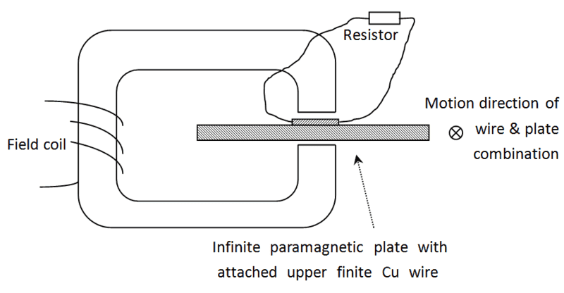

If I paste a copper wire on top surface of the movable magnetic core, then the conductor wire will cut MMF lines during rotation.
My new question: is there the induced voltage between the two ends of wire?
Of course, I know there must be an induced voltage, if keep the movable section standstill and let the wire independently cut through the gap.
But now the wire and the movable section are bounded together, and move together, so the induced voltage may no longer exist? or not render the same voltage value as scenario of everything standstill except the wire?
In new scenario, the movable section can be imagined as an infinite area plate, not have to rotate, but simply linear move.
The "ends" of your wire will be part of a loop (circuit), for example including your voltmeter leads. Any change in the total magnetic flux passing through that loop, either due to a time variation or spatial movement, will induce a voltage according to Faraday's Law. So I'm a bit unclear about how the field lines in your experiment are distributed throughout that entire loop.

If the flux within the loop doesn't change, there will be no voltage induced. The concept is relatively simple compared to actually knowing where the magnetic flux is. It's sort of a bookkeeping problem. Sorry, I don't know what "vertical to B" means. Nearly every time you see a problem like this it comes with a sketch of the geometry and field lines (flux). That's one big advantage to magnetic cores; you know where the flux goes and can usually ignore the flux outside of the core.

From reply #13, then after, I assume the cylinder is replaced with an infinite area plate with thickness equal to original height of the solid cylinder, and no more rotation, but linear motion.
My only concern is whether the motion of wire (combined with plate), is affected by the plate in term of induction effect.
By my imagination, the contact area between wire and plate seems not to cut B flux, as the motion may stickily drag the MMF lines if not instant straightening (reconnect to nearest magnetic domains); only the wire upper portion causes flux change?
Following sketch illustrates the combined wire and plate moving towards reader.
If the plate is attached with the C core, and let the wire independently move, is there the same induction effect?

Now I think the moving magnetic media seems not to affect conductor's induction, as DaveE says the MMF lines probably instant straightening.

I think I know what your trying to do. Creating a motor where the rotor is a single magnetic pole with field lines extending outwards or inwards along the whole rotor surface and the stator being the opposite magnetic pole , then you can put a wire in the airgap between the stator and rotor or attach it to rotor surface , pass current through that wire and it will continually be pushed around as it cuts the never ending single direction flux between the stator /rotor.I can say immediately that the first problem is that the magnetic loop has to be long , the longer a magnetic loop is the more lossy it becomes so you will need more energy to create the same strength field, or more permanent magnets, second problem is unless you wish to put slip ring on the periphery of the rotor where there is high angular speed you will have to use the rotor axis as a magnetic field return path, rotor axis are usually made from hardened ferrous steel which is not nearly as great in terms of magnetic permeability as soft magnetic steel used in laminations for transformer cores and electric motors.In theory it works, in practice it's worse in power to size/volume ratio, it's more complicated and it doesn't surpass existing motors/generators in the parameters.
Sorry to say but this is not a new idea , it's just not practically efficient or better therefore it's not used.
One additional note is that such a motor would have only a single turn in the rotor, so a very low resistance path which would be impractical for almost all applications and energy sources.
For more than single turn in the rotor you would need additional slip rings, so 1 turn needs 2 slip rings , 10 turns would require 20!!! slip rings one for each turn start and end.
It's essentially a faraday disc just with different geometry.

Think about it, it's simple, if your rotor to stator flux is all in one direction all around the rotor surface then you can't pass wire back and forth, you can only pass wire in one direction and current also in one direction.
If you put two wires next to each other and pass current in opposite direction then one wire will try to turn left while the other right, you will have a perfectly canceling torque and no movement.
Therefore for a design like this you can only pass current in one direction and then use a return path for the current that is OUTSIDE!!! of the flux that you are working with.
So yes you need two slip rings for each loop/turn of such a motor.
It does work in theory and would also work in practice it's just extremely inefficient to do a motor this way.
It has too long magnetic field path and needs alot of slip rings , or the other way is to do it like the faraday disc is done instead of many turns, have just a single turn but then you need huge amperage to get any real torque.
