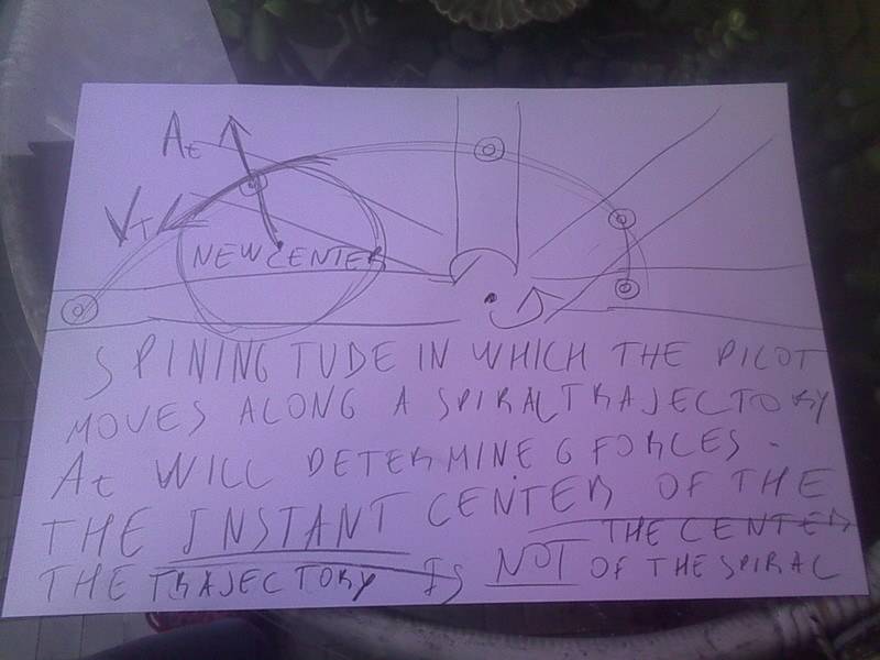

i think i figure it out with your help guys, thanks
the pilot makes a spiral trajectory and this is the key
but the center of curvature in a given instant is not the center of the spiral but its somewhere offset from the center
so you just have to calculate this center and obtain the normal aceleration with this new instant temporal center that will be the g forces the pilot will experiment as he makes an spiral trajectory

Your analysis is incorrect. Increasing the tube speed proportional to radius is NOT the condition that keeps the tube from touching him.
Start with the idea that with no acceleration he must move in a straight line. For there to be no acceleration the tube must be positioned around him at all times but not touch him
One might question how it came about that the pilot started moving in a straight line in the first place, but I didn't make up the problem. You did.
So if the pilot moves parallel to a radial, the initial tube velocity is 0 and dividing by the pilots radial position still gives 0. The tube does not move.
Now say the pilot moves at a constant velocity v starting at t0 on a tangent at radius r0. The pilots position at time t is angle = atan(v t / r0) and radius = sqrt((v t)^2 + r0 ^2)
For small angles atan(v t / r0) ~= v t /r0 and the angular speed increases linearly with time, but not linearly with the pilots radius. In fact at small times the sqrt approximates to r0 + (v t)^2 / (2 r0). For the tube not to touch him and keep the acceleration at zero the tube moves proportional to the square root of the radial position. This is because in addition to the radius becoming larger the fraction of the velocity which is tangential becomes less and less. This is where your logic failed. Any other motion of the tube, say angular velocity proportional to radius as you propose WILL accelerate the pilot.
well obviously as soon as the wall of the tube pushes the pilot he will feel g forces and if he goes in a staright line the tube is not spining which is a condition
what i initially failed to see is that the center of the trajectory at a given instant is not the center of the spiral but the center of curvature of that portion of the spiral where the pilot is at the given instant
if instead you wrongly take the center of curvature in the center of the spiral that's when the contradiction appears

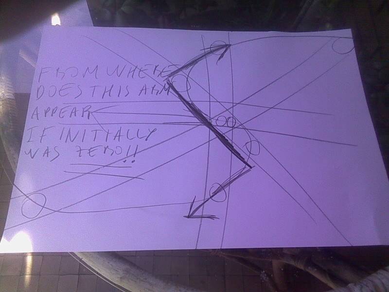

i still have some trouble with this case problem:
imagine the case there are two counterrotating tubes in space:
the tubes are massless and frictionless, i can make this assumption for being them counterrotaing they still can apply a torque
there are two astronauts in the center of each tube and exactly at the same moment they start a centrifugal gravity free fall
we measure their trajectory exactly in the moment both astronauts intersect
the trajectories will be V which added will be a I aiming up
if initially the astronauts vectors in an isolated system was zero, how can it the isolated system go to a vector I aiming up without counterpart since the tubes are massless and hence can not have a vector
i hope you don't mind me asking questions of things i don't see and setting my self physics problems in order to solve them for entertainment

now a last case that will help me understand vectors and their arms:
now there's a single masless frictionless tube in space and two astronauts that jump to free fall artificial centrifugal gravity in opposite sense
initially there's a vector aiming upwards from the surface of the paper where the drawing is
how did it mathematically go to those two opposite vectors and the growing arm?
What you describe cannot happen without some external torque.

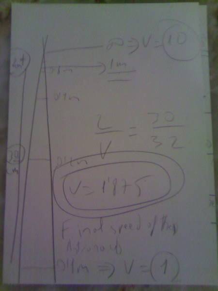

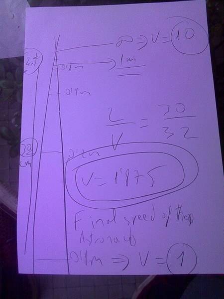

well here my answer after much thought about it:
if you were a teacher and you put this unexpected problem as real problems are let's see if I've found the right solution and i pass or not and i fail :)
the problem is pretty simple to solve accounting for one thing:
you can take the astronauts are on artificial gravity free fall and hence are acelerated radially
the magnitude of this centrifugal gravity aceleration with the given parametes would be 1 m/s2 or 0.1 G
so hence after 1 m fall both astronauts speeds will be aproximately 2 m/s
conservation of energy is acomplished for the increase of energy of the astronauts comes with a decrease of energy of the spinning tube
conservation of momentum keeps true as well for the spiral trajectory they make is a kind of spiral not fractal but that opens more and more and hence the arm between each astronaut trajectory vectors reduces as the atronauts advance
in infinity the tube will remain still and all energy of the system will have gone to the astronauts having both an speed of aproximately 10 m/s, you could calculate the arm between these two vectors accounting for the initial momentum that wouldn't have changed
as the artificial gravity force reduces each moment the final result of the problem is not 2 m/s but slightly less what I am trying to figure out now
edit:
well the eacts answer would be an speed of 1.875 m/s after one meter free fall
as i don't remember very well how to integrate i solved it by thales:
