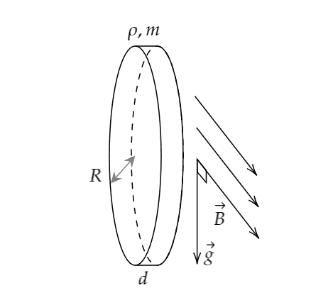

I'm trying to figure out the exact current between the two plates of a disk with resistivity p, mass m, radius R and thickness d, falling in a uniform magnetic field that are parallel to the disk's surface and perdipencular to gravity field.
##\displaystyle J=\frac{1}{\rho } .\mathbf{E}##
The original question was to find the final velocity after falling from the height ##H##
In many correct solutions to this problem, they consider the current density between the two surfaces to be ##\displaystyle J=\frac{1}{\rho } .\mathbf{E^{*}} =\frac{\mathbf{v} \times \mathbf{B}}{\rho }##

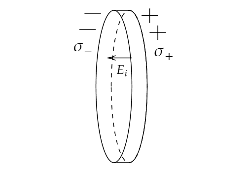

But I think there must be an internal electric field ##E_i## inside the disk, caused by the surface charge density, because the charges cannot change immediately due to resistance. So, electric current would be ##\displaystyle J=\frac{1}{\rho } .(\mathbf{v \times B-E}_{i})##
Is there anything that was mistaken?

Yes.
There is a conducting disk with resistivity p, mass m, radius R, and thickness d, falling in a uniform magnetic field from a height of ##H## (the field is parallel to the disk's surface and perpendicular to the gravity field, as illustrated in the image). Find the final velocity of the disk when it reaches the ground.
I agree with you. The internal electric field ##E_i## needs to be taken into account.
##E_i = \sigma/\varepsilon_0## and ##J = \dot \sigma##.
I believe you can set up two coupled, first-order differential equations for ##\sigma(t)## and ##v(t)##, where ##v(t)## is the speed of fall of the disk. When I do this and solve for ##v(t)##, I get that ##v(t) \approx g t## for any reasonable choice of values for ##B##, ##\rho##, ##R##, ##d##, and ##m##. So, the disk will essentially fall with constant acceleration ##g##.

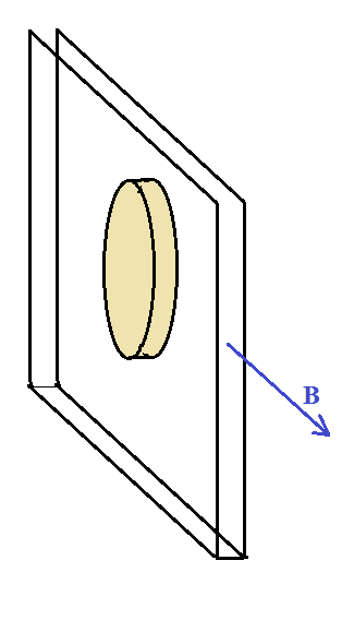

For example, we could imagine the rod (disk) sliding vertically between two conducting plates such that the plates are connected at the bottom. The disk makes contact with the plates with negligible friction. So, we have a complete circuit for current to flow around. Now we would get a terminal velocity as you calculated.
With positive charge built up on one face and negative charge on the other, won't there be a torque causing the disc to rotate to be parallel to the field?
My right hand is telling me that the forces on the faces are in the direction to cause the faces to repel each other without any torque on the disk.
Sorry, I didn’t look at the diagram carefully enough. I thought the field was parallel to the axis of the disk.

I did try to solve the differential equations.
From the given assumptions and the second Newton law, we can set up two equations:
$$\dot{q} =\frac{S}{\rho }\left( v.B-\frac{q}{S.e}\right)$$ (1)
$$\dot{v} =g-\frac{B.d.\dot{q}}{m}$$ (2)
Take the derivative of (1) over time, then substitute to (2), we have the second order differential equation for ##q##:
$$\frac{1}{B}\left(\frac{\rho \ddot{q}}{S} +\frac{\dot{q}}{S.e}\right) +\frac{B.d.\dot{q}}{m} =g$$
$$\ddot{q} +\left(\frac{B}{\rho e} +\frac{d.S.B^{2}}{\rho m}\right)\dot{q} =\frac{gBS}{\rho}$$
With the initial condition ##\dot{q}_{(}{}_{0}{}_{)} =0##, we have the function ##\dot{q}_{(}{}_{t}{}_{)}##:
$$\dot{q} =\frac{gBS}{\rho \alpha }\left( 1-e^{-\alpha t}\right)$$,in which $$\displaystyle \alpha =\frac{B}{\rho e} +\frac{d.S.B^{2}}{\rho m}$$
Take the intergral, we have the function ##q## of ##t##:
$$q=\frac{gBS}{\rho \alpha }\left( t-\frac{1}{\alpha } +\frac{1}{\alpha } e^{-\alpha t}\right)$$
Then we have ##v##:
$$\displaystyle v=\frac{1}{B}\left(\frac{\rho \dot{q}}{S} +\frac{q}{Se}\right) =\frac{g}{\alpha }\left( 1-e^{-\alpha t}\right) +\frac{g}{\rho e \alpha }\left( t-\frac{1}{\alpha } +\frac{1}{\alpha } e^{-\alpha t}\right)$$
So I think after a long time of falling, the disk won't reach a terminal velocity. Instead, it will experience a constant acceleration of ##\frac{g}{\rho e_{0} \alpha }##
##e## is the electric constant, I don't know why it cannot be displayed
Is it correct?

Check the last equation above. In the parentheses on the left side, the first term should not have ##B##. It should be ##\dfrac{1}{\rho \epsilon_0}##.
This will change your expression for ##\alpha## where you have
It should be
$$\displaystyle \alpha =\frac{1}{\rho \epsilon_0} +\frac{d.S.B^{2}}{\rho m}$$
Note that ##S d## is the volume of the disk. So ##\alpha## can be expressed in terms of the volume mass density ##\mu## of the material of the disk: $$\displaystyle \alpha =\frac{1}{\rho \epsilon_0}+\frac{B^2}{\rho \mu} = \frac{1}{\rho \epsilon_0}\left(1+\frac{B^2 \epsilon_0}{\mu}\right)$$ Since ##\epsilon_0## has the value 8.85 x 10-12 C2 /(Nm2), the dimensionless quantity ##\dfrac{B^2 \epsilon_0}{\mu}## inside the parentheses will be negligible compared to 1 for any reasonable values of B and ##\mu##.
For the acceleration of the disk I find $$ a(t) = \frac{g}{1+\frac{B^2 \epsilon_0}{\mu}} \left(1+ \frac{B^2 \epsilon_0}{\mu}e^{-\alpha t}\right).$$ Since ##\dfrac{B^2 \epsilon_0}{\mu} \ll 1## for any reasonable choices of ##B## and ##\mu##, we see that ##a(t) \approx g## to a very good approximation.
