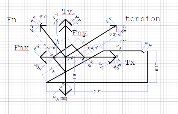

The father stands at the summit of a conical
hill as he spins his 20 kg child around on a 5.0 kg cart with a
2.0-m-long rope. The sides of the hill are inclined at 20 degrees. He
keeps the rope parallel to the ground, and friction is negligible.
What rope tension will allow the cart to spin with the same
14 rpm it had in the example?
F=mrw^2
I drew the fbd diagram, and I got two equation :1. Fny +Ty=mg and 2. Tx-Fnx=mrw^2
where Fnx and Fny is the x, y-component of the normal force, Tx and Tx is the x, y-component of the Tension.
But I don't know how to solve for Fn

Can anyone help me?

You have two unknowns, Fn and T. You want to find T, not Fn. use one equation to eliminate Fn from the other.

Cc518 said:
Thank you for reply!
I got tention as 179.2n, but the answer I got from other sources is 185n.
The fbd they used is different than mine though.
share.aspx
https://cloud.smartdraw.com/share.aspx/?pubDocShare=3584F28114431EA1F27BA700C6061213131
They said Tention= mrw^2-mgx
Which one is correct?
I get 178.7N.
Did you mean they get mrω2+mgx?
That overlooks that the rotation is in the horizontal plane, so need to take the upslope component of mrω2 to align it with the tension. And r here, of course, is the radius of the rotation, not the length of the rope.
Likes Cc518
haruspex said:
I get 178.7N.
Sorry, I meant mrω2+mgx actually.
So is the rotational plane horizontal or is it parallel with the incline of the slope?
In other words, does the Tx act as centripetal force or does T act as the centripetal force?
Thank you :)
What do you think?
haruspex said:
What do you think?
I think it should be horizontal because if the plane is parallel to the incline of the slope, the object, in this case, the cart, will move up the slope, which is not what happened.
Right.
haruspex said:
Right.
Thank you so much for your help! I really appreciated it!
It contributes to the centripetal force. The normal force also affects it.
Oh, yeah. Thank you for the reminder :)
