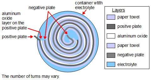

Why do electrolytic capacitors are electrolytic? I mean, I know an electrolyte allows current to flow for example in water, by placing salt in it. The electrolyte is between the plates, but there should be an isolator instead, not a conductor.
The "plates" are made of aluminum. By inducing dc-current through the assembled capicitor, the surface of one of the plates is anodized, which creates an insulating layer ( aluminum oxide ).

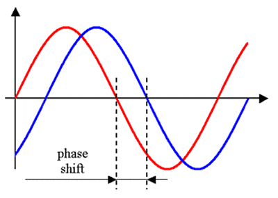

Thank you for your answers guys, I will check out the material you posted on this thread. I got another question, can there be a current division caused by a capacitor? As you said above, there can be current in a capacitor when it comes to AC voltages as long as there are high frequency voltages. If I got a capacitor in parallel with a resistor, can we say the current is going to be divided as two resistors in parallel do?
Yes you can. But now you must calculate with complex values:
The resistance of a resistor = R.
As for a capacitor the corresponding impdance, ZC = 1/jωC.
So if you supply a voltage V to a resistor and a capacitor in parallel, you will get the currents:
IR = V / R
IC = V / ( 1 / jωC ) = V*jωC
The sum of the currents will be IRC = V*( 1/R + jωC ) which is a complex current: The voltage V has not the same phase as the current IRC.
The resistor will conduct the real part of the current, and the capacitor will conduct the imaginary part. You can measure both currents with an amp-meter. ( The imaginary current is not that imaginary :smile: ).
Voltage Current
I don't think this has been dealt with at an introductory level and it could help the OP. The Capacitance of a Capacitor is inversely proportional to the spacing of the plates. There is a limit to how thin you can make a mechanical dielectric film of uniform thickness so it's necessary to make very large Capacitances with a big plate area, which makes them inconventiently big. In a electrolytic Capacitor, the dielectric is made electrolytically and can be much thinner, giving a many times higher Capacitance for the same component volume (but their breakdown voltage can be relatively low). When the Capcacitor is formed, it's a bit like a reverse biased diode, which will not conduct but the dielectric that's formed from the electrolytic action is fairly stable and insulates as long as there is never a negative bias across the plates. So electrolytics need to be placed in a circuit with the + terminal more positive than the - terminal or they can depolarise and start conducting. If left unused for a long time, the early electroytics needed to be rejuvinated with a DC voltage for a while. Modern ones probably don't need this treatment.
Hope that's not too much of a noddy description.
Likes nsaspook
If you need a non-polarized electrolytic in a purely AC circuit you use two in series (externally or internally) with the capacitor polarities reversed so one is always reversed while the other is conducting.
http://www.cde.com/resources/catalogs/AEappGUIDE.pdf
If two, same-value, aluminum electrolytic capacitors are connected in series with the positive terminals or the negative terminals connected together, the resulting single capacitor is a non-polar capacitor equal in capacitance to half of the rated capacitance of either of the original pair. The two capacitors rectify the applied voltage and act as if they had been partially bypassed by diodes. However, at all levels of AC voltage the apparent capacitance is half of the rated capacitance as you would expect for capacitors connected in series. The nonlinear performance produces distortion where non-polar aluminum electrolytic capacitors are used in audio AC applications. In non-polar aluminum electrolytic capacitors and motor-start aluminum electrolytic capacitors a second anode foil substitutes for the cathode foil to achieve a non-polar capacitor in a single case. These are available for momentary-duty AC applications like motor starting and voltage-reversing applications, but the high DF of aluminum electrolytic capacitors – from 2% to 150% – causes excess heating and short life in most AC applications. Aluminum electrolytic, motor-start capacitors are non-polar and designed for intermittent operation in starting single-phase induction motors or for other brief AC applications such as motor-run capacitors in electric door openers.
