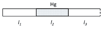

A glass tube with a section of ##A= 10^{-4} m^2## and length ##l=1.14 m## is closed at one end and open at the other end. Inside the tube there's a mercury's column ##l_2=0.3 m##. When the tube is placed horizontally, the columns of air on the right and left of the column of mercury have the same length ##l_1=l_3=0.42 m##. The tube is now placed vertically with the open end to the top. Determine the length of the column of air ##l_1'## of the closed end. How long the length ##l_1''## of air would be if the tube was closed before it was placed vertically? Assume temperature constant during every process, air is a perfect gas and ##ρ_{Hg}=13.6 ρ_{air}##.
Boyle's law: ##P*V=constant##
I guess I have to find out something when the tube is on the horizontal.
What force should I consider? Is the pressure of the air inside still ##p_{atm}##?
When it is on the vertical, the equation is something like this?
##P_{Hg}+p_{atm}*A=p_{atm}*A+ρ_{air}*A*(l_1-l_1')*g## with ##P_{Hg}=ρ_{Hg}*A*l_2*g## weight of the column of mercury.
Or maybe I shouldn't face this problem considering the force...?
Please try to justify your equation. (I fail to see how the weight of air in the closed section comes into it.)
That was just an attempt, I don't even think that is right.
I considered as downward forces the weight of the column of mercury ##P_{Hg}## and the atmospheric pressure times the section ##p_{atm}*A##.
I considered as upward forces the bouyant force ##ρ_{air}∗A∗(l1−l′1)∗g ## and the pressure of the air in the closed section. Is it right to consider the bouyant force? What about the pressure of the closed section?

Indeed, what about it? What law tells you how the shrinkage in its length leads to greater pressure?
Boyle's law. My main dubt is: can I consider the initial pressure of the closed section ##p_{atm}##? Why?
In such case, it would be ##p_{atm}*A*l_1=p_{f}*A*(l_1-l_1')##
But I still need something else. Where should I look for it? Do I have to adjust the equation of forces (when the tube is on the vertical)?

Yes, because while horizontal any difference from atmospheric pressure would have caused the mercury to move.
Doesn’t look right to me.
Always worth checking trivial special cases. What does your equation give if l1 doesn't change?

It gives ##p_{atm}=p_f##. Why is this wrong? If ##l_1'## doesn't change, the air would take the same volume.
Anyways, how should I apply Boyle's law?
EDIT:
well, now I got it: ##p_{atm}*A*l_1=p_f*A*l_1'##.
What is the next step?

Write the force balance equation for the mercury using pf.
Is this right?
##ρ_{Hg}*A*l_2*g+p_{atm}*A=p_f*A##
The first term is the weight of mercury. (On the homework statement I did a mistake ##ρ_{Hg}=13.6*ρ_{H2O}##)
If yes, then ##l_1'=0.3 m##.

Correct.
The easiest way is to start with atmospheric pressure as 0.76m of Hg. The 0.3m in the tube is going to increase the pressure to 1.06m, i.e. in the ratio 106/76. So the volume of air is reduced in that ratio: (76/106)0.42=0.3.

For the second part (the tube is completely closed before it is on the vertical), do I have to repeat the reasoning I did before?
Now, when the air under the mercury is compressed, the air above the mercury expands.
Boyle's Law:
##p_{atm}*A*l_1=p_1*A*(l_1-x)## for the air under the mercury
##p_{atm}*A*l_3=p_3*A*(l_3+x)## for the air above the mercury
and by the force balance equation:
##ρ_{Hg}∗A∗l_2∗g+p_3*A=p_1*A##
3 equation and 3 unknows ##p_1##, ##p_3## and ## x##. Then I can find ##l_1''=l_1-x##
Let me know if this is right please.
Just one last thing, why can I consider the length of mercury constant? I did it for the first part of the problem too.

Looks good.
Why would it change (by more than a minuscule amount)?
