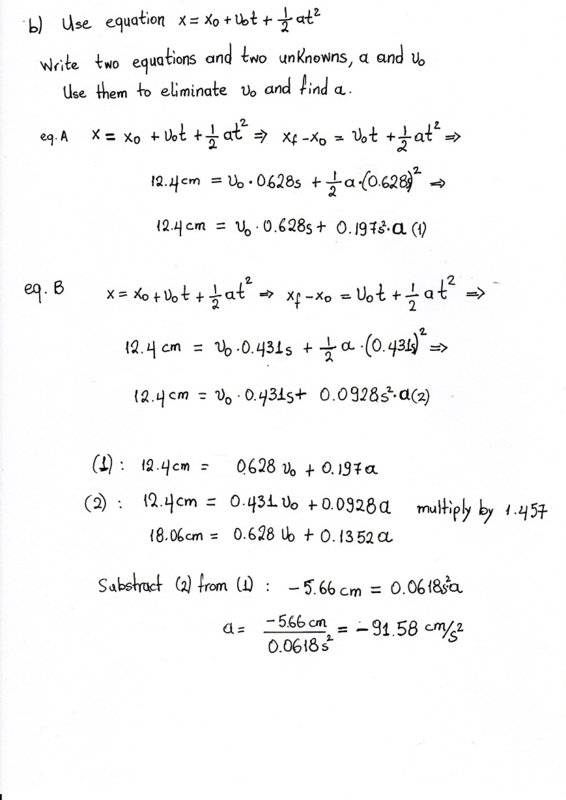

Is the following correct? (for part b)
The first equation is correct but the second equation is not. You use the symbol ##v_0## to denote the velocity when the front end of the glider crosses point A. Because the glider accelerates, the velocity will no longer have that value when the glider crosses point B. You need to connect with an equation the velocity of the glider when its leading edge crosses point A, call it ##v_{0A}##, to the velocity of the glider when its leading edge crosses point B, call it ##v_{0B}.##

Hi! Do you mean this equation ##v_{0B} = v_{0A} + at## where t = 0.628s + 1.39s ?
That's exactly what I mean!

Personally, I would attack this by noting that, for constant acceleration, the velocity at the mid-point of a time interval is equal to the average velocity over that time interval.
That fact seems intuitively obvious, but can be derived if needed:
$$v_{ave} = \frac{v_i + v_f}{2}$$
$$= \frac{v_i + (v_i + a \Delta t)}{2}$$
$$= \frac{(v_i + a \Delta t/2) + (v_i + a\Delta t/2)}{2}$$
$$=\frac{2(v_i + a \Delta t/2)}{2}$$
$$=v_i + a \Delta t/2$$
$$=v_{mid time}$$
This clears the way for a very straightforward calculation.
Likes neilparker62
Yes indeed, I was saving that approach for later, after OP completed the problem. The second approach makes the algebra simpler while the first approach has an easier-to-understand strategy and setup.
@J.Briggs - you beat me to it! Was just checking result on Wolfram Alpha as compared to OP's calculations as corrected by Kuruman. This is a very useful method to employ for (uniformly accelerating) projectiles passing a given space 'window' in a given time 'window'.
