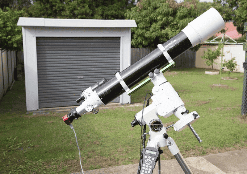

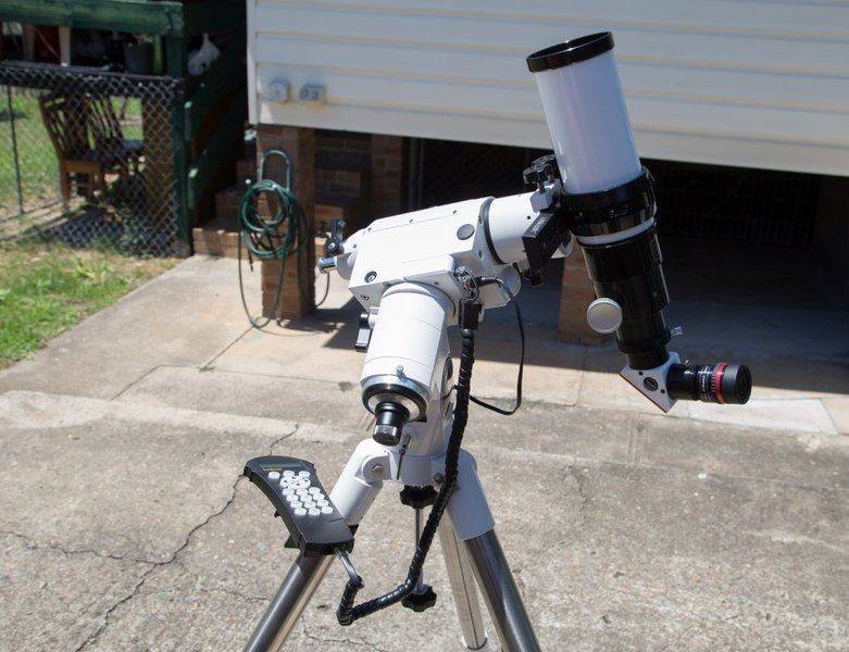

Hi there
As others have said, $500 ( and I'm assuming that is US$) is a bit on the low side
You really are looking at US$1000 and up for a respectable solid mount.

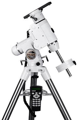

This is the one I have ...
https://www.bintel.com.au/product/skywatcher-heq5-pro-goto-mount/
It's an excellent and solid mount for telescopes up to 13.5 kg (~ 6 lbs)
AU$1300 = approx US$1000 at current exchange rate
I use mine for my solar scope
as well as my big refractor
This is a GOTO mount = when the mount is polar aligned correctly ( you need to do that anyway for astrophotography) you can use the hand controller's database to get the mount/scope to go straight to an object

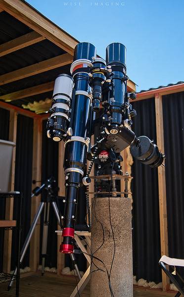

Well with a good mount, you may be able to put both scopes on the one mount at the same time
both your scopes are reasonably small and a mount like my one in the pix above would handle them both easily
my mate, Martin, from Florida really goes to the extreme with 4 optical systems on the same mount ...
I'm not suggesting you go that extreme, just showing what can be done with a decent mount :smile:Dave

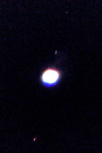

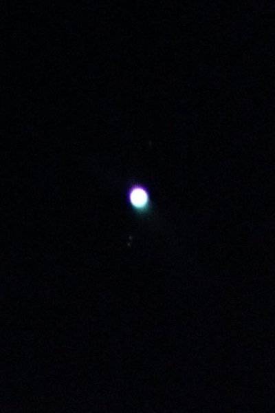

Let's just start with one for now :oldbiggrin: But in all seriousness that's something I never thought about! I'm definitely going to try that. I remember when I manually tracked Jupiter to get a picture of it, oh boy did that take some luck.
1.Low exposure
2.regular
3. increased contrast of the second image
