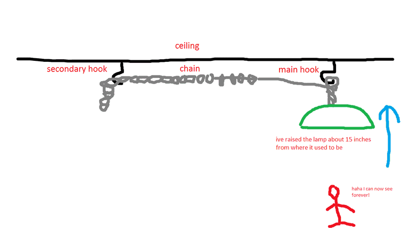

hello, I am new to this forum (so bear with me)
I've got a lamp on the ceiling of my kitchen, its got a particular setup that Ill try to reproduce
ceiling---------------------------------------------------------
-----------------hook------------------------hook--------
-----------------extra chain------------------chain with lamp attached
---------------------------me cooking delicious food terrified the glass lamp is going to fall on my pretty face and deform me like horrible universal monster---------------------
so the deal is, the lamp used to hang lower, meaning there was like 15 inches of chain between the lamp and the main hook nailed to the celing. Now because I am gorgeous and tall I've decided to raise the lamp higher so the light can illuminate further. I know, I know, its an awesome idea, how do I come up with these ideas by myself? I truly don't know, its just inspiration, magic if you want.
Now the lamp is very close to the ceiling and very high, I've had to move the extra chain to the secondary hook. My questions are:
1/ if you can visualize the setup, is now the main hook bearing more weight than before now that the lamp is closer to the hook, therefore is the hook in danger of separating from the ceiling and falling into my head, or my cats heads (big surprise but I am single and live with cats, what a catch! I am open to offers clever ladies)
2/ which formula would you apply to calculate this
3/ finally this is the drawing of the situation (you can keep it, its my way of giving something back to humanity)

no, the hook is bearing less weight than before
it is now bearing the whole weight of the lamp, and the weight of that short piece of chain, and half the weight of the rest of the chain
(before, it was bearing the whole weight of the rest of the chain)
i assume you are thinking that the higher the lamp is, the more force the hook must be doing to keep it there …
no, you did the work to get it there, the hook only has to use the force to keep it there, and the keeping force is the same at any height :wink:

The main difference in the setup now is that, should the main hook let go, the secondary hook should tend to swing the falling lamp away from that pipe-cleaner figure directly below, until a point where the secondary hook, too, let's go. :smile:
The lamp's power cord will play a part during that sequence, but not much can be foretold as the placement of the cord has not been shown in your blueprint.

which formula would you apply in this case? or what physics principle?
Newton..
Force = mass * acceleration
You have reduced the mass hanging from the main hook. Some is now supported by the other hook.
