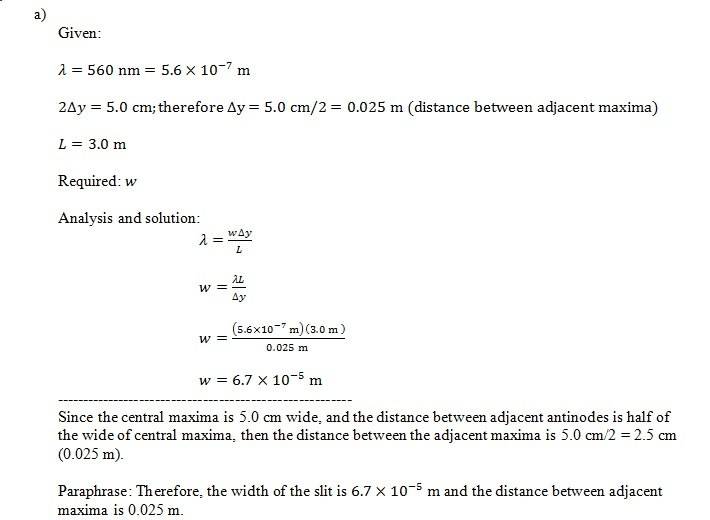

a) see attached.

I was wondering if there's anything that i missed? I feel I have it all but I just want to be sure. Also, for questions B and C, i had a hard time learning the concepts during class as the videos my teacher showed hurt my eyess so it was kind of hard to see the differences in the waves/ dark and bright fringes.

If the central maximum is 5 cm wide, how can the distance between adjacent maxima be 2.5 cm? That is less than the width of the maximum.

Hmm did I approach it wrong? From what i have in my notes, the central maxima is twice as wide as the other maxima. Since Central Maxima was given I used the formula 2(Triangle)y to find the distance between the other maxima. :/ unless I'm forgetting something crucial.

Ah, so your "distance between maxima" applies to all other maxima? Then it should be fine.
