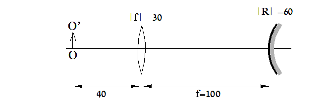

A body is positioned 40 cm from the left of a lens (f=30) and the lens is positioned 100cm left of a convex mirror (|R|=60), where will be the image and what type and magnitude will it have?
1/u + 1/v = 1/f
I tried to calculate the image after the lens - and got v = 120 cm.
Now, I don't know how to interpret the answer.
Can anyone help me out on this?
Thanks

The convex mirror interrupt the rays to form the real image.
So (120 - 100) = 20 cm becomes the virtual object distance for the convex mirror. Now proceed.
That's my problem, now it is considered concave?
You can consider the mirror concave, and find the image distance that way, or you take it convex and use negative object distance.
