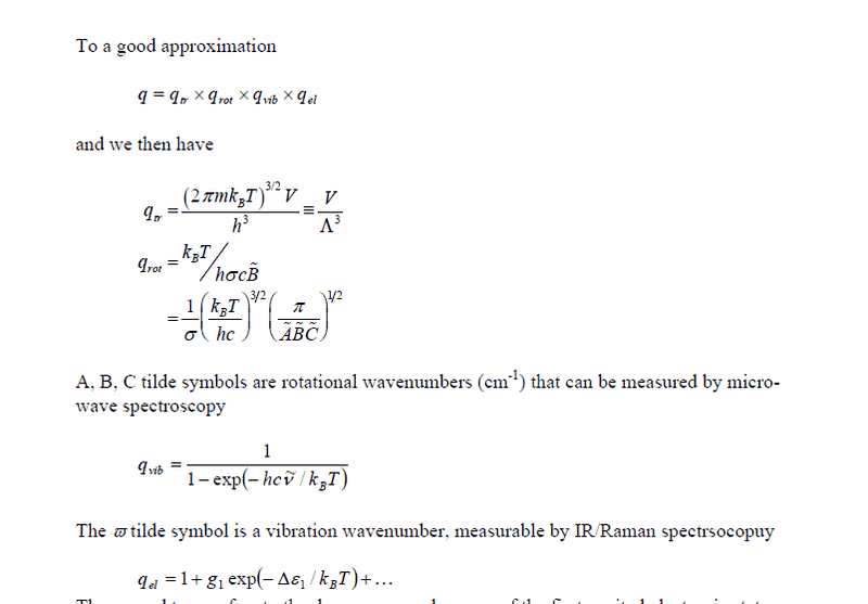

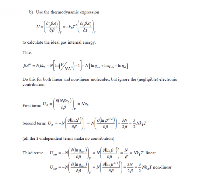

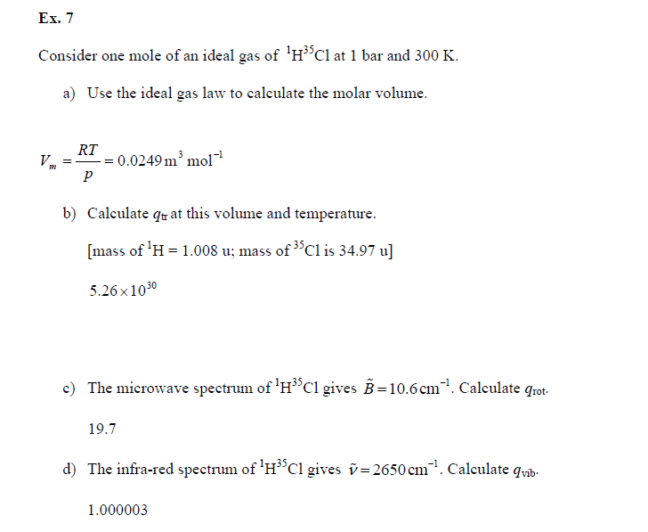

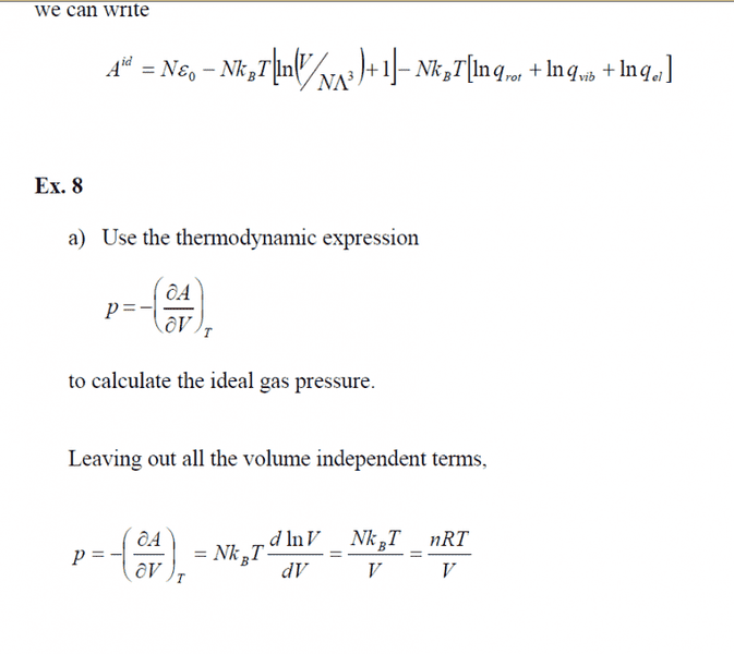

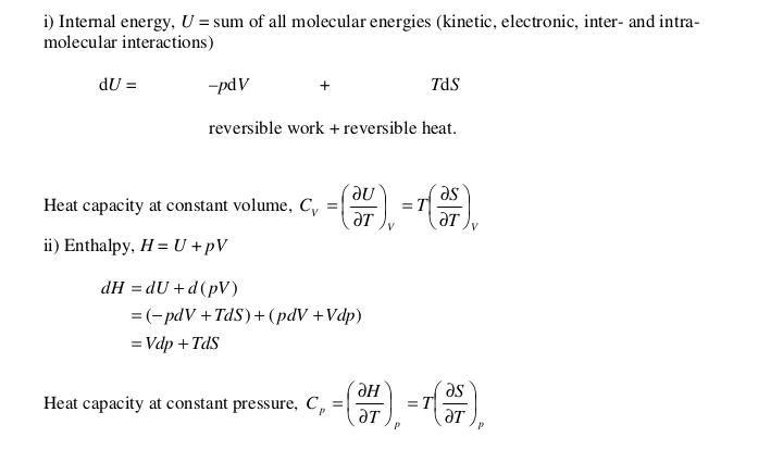

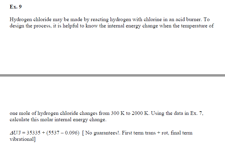

I will attach some photos, and if you don't mind could you please have a look over?
I am really keen in understanding the phenomena, and the notations .
Regarding the lower part with the Heat Capacity at constant volume Cv.
I assume that on the right corner at the bottom of the bracket that V stands for V=constant
but I quite not get the ##\frac{δH}{δT}## part
Why is the meaning of this why would divide H(enthalpy) by T(temp in K)
I also assume "δ" as a small change right? not as a "d" as a bigger difference.
I would be more than glad if you could also help me with the 2nd picture(Please have a look below if it is possible)
I quite can't understand why they used "d" and then "δ" like with ##df=\frac{df}{dx}*dx+\frac{df}{dy}*dy##
Also how they got that ##p=\frac{-δA}{δV}## at constant T
And also they said we know from Calculus that in the 2nd Derivative , but they basically switched δx with δy on the bottom , in the multiplication.I am trying to understand the physics phenomena in terms of differentiation, and also the notations with those derivatives.
Am I right?Please feel free to correct me, and also add , I am keen on learning more.

Could you also please explain me if you have time what is about that partial derivative in post #5?
Thank you very much in advance.
Ok, I got around to reading #5, turns out I didn't need to brush up on thermodynamics so much for a simple reason: you are putting the cart before the horse. Let me explain. You are trying to learn material that uses partial derivatives and functions of two variables, before you even understand and are familiar to derivatives of functions of one variable. My suggestion is make sure you understand the derivative of a function of one variable well and that you have a lot of practise with differentiating, before moving on to partial derivatives.
Martin Harris said:
dU=-PdV+TdS
what is the semnification of the small "d" is it like a Δ right?Like a small change right?
Not quite. ##\Delta## is used to talk about differences, whereas ##d## is used to talked about differentials. I will define this in the case of one variable. Let ##f## be a differentiable function (of one real variable). Fix a real number ##x_0##. Then the differential ##df## is a variable that can be written as a function of the variable ##x## (in the same way ##y## can be written as a function of ##x##, or ##y=f(x)##), as defined by this equation:
$$df=f'(x_0)(x-x_0).$$ We can make a nicer looking equation by defining ##dx=x-x_0##. Then
$$df=f'(x_0)dx.$$ Intuitively, since ##df## depends linearly on ##x##, it can be visualized by a line. Which line? Precisely the tangent line to ##f## at point ##x_0##.
So if you want to compute differentials, you must compute derivatives. The case ##dU## is based on the same principle, but ##U## is not a function of one variable, so I will not go into it.
That is correct.
Martin Harris said:
but I quite not get the δHδTδHδT\frac{δH}{δT} part
The notation that you are referring to, used in the picture, is called partial derivative, ##\frac{\partial H}{\partial T}##.
Martin Harris said:
I quite can't understand why they used "d" and then "δ" like with df=dfdx∗dx+dfdy∗dydf=dfdx∗dx+dfdy∗dydf=\frac{df}{dx}*dx+\frac{df}{dy}*dy

However the thing that confused me in post #5 in 1st picture let's say is that he did partial and outside the (δU/δT) he put V which means V=ct.
This means that we will differentiate the function U with respect to T at V=ct.
I know at V=ct that P1*V1=P2*V2 isothermal
Also 2nd picture in post #5 is confusing .
So how exactly to approach that partial derivative?
Thank you very much in advance!
No, it means the partial of U with respect to T, with V held constant.
Here's the notation I think you're referring to:
$$\left(\frac{\partial U}{\partial T}\right)_V$$
I'm not sure which one you mean.
In the middle of that page is this equation:
$$dA = -p~dV - S~ dT$$
In the first equation below that, they are taking the partial of A with respect to V, with T held constant. If T is constant, dT = 0, and they are essentially taking partials wrt (with respect to) V of both sides of this equation: ##dA = -p~dV##, and solving it for p.
Similar idea for the equation just below that one.
Likes Martin Harris

Thank you for your reply.
In post #5 in 1st image at heat capacity at V held ct ,outside the brackets of the partial derivatives.
They say Cv=(δU/δT)V held ct
what is the difference between Cv=(δU/δT)V held ct and this Cv=(δU/δT)
Thank you
What I said before that you apparently didn't see:
Mark44 said:
You are using δ (lowercase Greek delta). You should be using this character ∂, as in ∂U/∂T. Click on the ∑ menu item above. It's one of the characters that are available.
Earlier you wrote "at V = ct" which I assumed meant that V was set to some constant c times t, presumably time. "ct" is not a recognized abbreviation for "constant" so you threw me off by using "ct" in this way
Not much, really. Here the assumption is that U is a function of V and T; i.e., U = f(V, T).
∂U/∂T means the partial of U with respect to T. It is understood that V is held constant. The notation (∂U/∂T)V just emphasizes that V is held constant.

Now I have another issue ,regarding this picture(please have a look below)
So, we have that Helmholtz Energy called A id.Then he says that pressure p=partial of A with respect to V at T=ct;
So we need to derive the A id expression with respect to V.
I quite don't get it how exactly he got ##N*Kb*T*\frac{d*lnV}{dV}## I don't get from where he got d*lnV/dV
where Kb=Boltzmann constant
N=number of particles
T=temperature
V=VOLUME
Aid=Helmholtz Energy
n=number of moles
R=8.314
Could you please to the derivation step by step so I can understand better?Or explain on steps what he did there?
I mean it is obvious that in our case our variable will be V, and all the constant will be treated as constants in our derivation.
We were expecting our P to be = ϑRT/V
Thank you in advance sir!
In the equation for Aid that's the first equation in the image, the Nε0 term and the last term on the right (-NkB[...]) are either constant or involve T. With T held constant (please don't write this as T = ct -- this is very confusing), he ignores all of the terms that are independent of V.
This gives ##A = -Nk_BT[\ln(\frac V {N \Lambda^3}) + 1] ##, which can be simplified to ## -Nk_BT[\ln(V) - \ln(N \Lambda^3) + 1]##
Next, he takes the partial derivative of A with respect to V, getting
##\frac{\partial A}{\partial V} = -Nk_BT \cdot \frac {\partial} {\partial V}[\ln(V) - \ln(N \Lambda^3) + 1]##
##= -Nk_BT \frac {\partial \ln(V)} {\partial V}##
Note that the 2nd and 3rd terms in brackets above are constants, so their partial derivatives are both 0.
##\frac{\partial (\ln(V))}{\partial V}## is the same as ##\frac {d(\ln(V))}{dV}##, since we're taking the partial with respect to V of a function only of V, so he rewrites the equation above as ##\frac{\partial A}{\partial V} = -Nk_BT \frac{d(\ln(V))}{dV}##
##= -Nk_BT\frac 1 V = -\frac {Nk_BT} V##

Also looking at picture, could you please tell me how he made transition from nkBT* dlnV/dv to NKbT/V ?
Thank you sir very much
  • #33
What is ##\frac d {dx} [\ln(x)]##?
This is one of the first differentiation rules that you learned in calculus. You won't be able to follow a discourse in thermodynamics using partial derivatives if their are gaps in you knowledge of single-variable calculus.
Likes Martin Harris
  • #34
Yes, I understood is 1/V because of the ln derivation.

And last confusion I have is regarding this problem.
Please have a look below if possible.
In 1st picture we have the formulas for various energies.
In 2nd picture I solved the exercise plugging in numbers in the formula and I got right answer.
My problem is in the 3rd picture.
that 35335 comes from ΔU=ϑCvΔT I guess, but why?
And also when I try to compute the other 2 terms from the brackets I cannot manage to get that values?
I use same formulas as in 1st picture but instead of T=300K I put T=2000K and still don't get the values.
Thank you very much for your understanding and cooperation.
