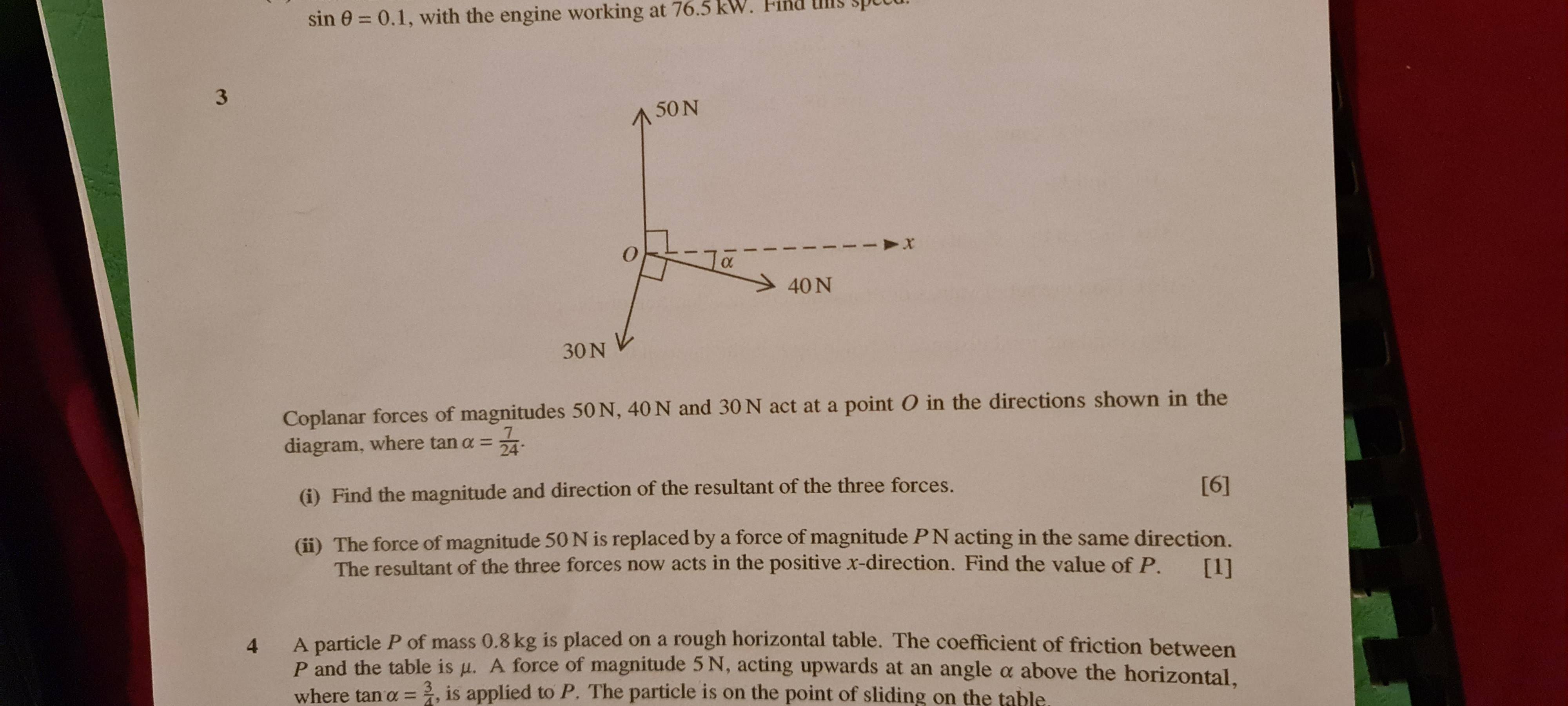

It's question 3. Iam getting a bit confused with the calculations. Pls help

On which part are you stuck? In each case you add the vectors by components.

Iam getting confused with 30 N.
So f(x) = 40cos alpha - 30 cos alpha
F(y) = 40 sin alpha - 30 sin alpha
You have three forces, each having x, y, and z components. So:
\(\displaystyle 40 ~ cos( \alpha ) \hat{i} ~ + 40 ~ sin( \alpha ) \hat{j} ~ \text{N}\)
\(\displaystyle 30 \hat{j} ~ \text{N}\)
\(\displaystyle 50 \hat{k} ~ \text{N}\)
Add them and you get F.
-Dan
the problem statement says the three given forces are coplanar, so you are dealing with x and y components …
$\sum F_x = 0 + 40\cos{\alpha} - 30\sin{\alpha}$
$\sum F_y = 50 - 40\sin{\alpha} - 30\cos{\alpha}$
$|F_{net}| = \sqrt{(\sum F_x)^2+(\sum F_y)^2}$
$\theta = \arctan\left(\dfrac{\sum F_y}{\sum F_x}\right)$

Thank you so so much!
