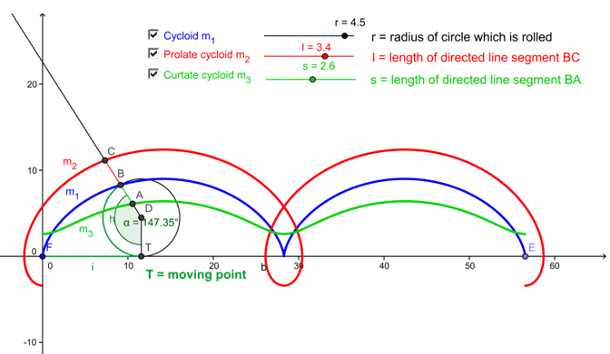

I am probably confused, but I visualize a cycloid trajectory (respect to the sloped surface) of the embedded particle P of mass m.
Induced solely by gravity acting on that mass, I see the rotational velocity of the disk as not constant but increasing while reaching a point prior to C (vertical line with the center of the disk) and decreasing while moving away from that point of minimum potential energy respect to C.
