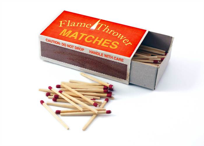

a match box consists of an outer cover, open at both ends, into which slides a rectangular box without a top. The length of the box is one and a half times its breadth, the thickness of the material is negligible, and the volume of the box is 25cm^3 . If the breadth of the box is x cm, find , in terms of x, the area of the material used. Hence show that, if the least area of material is to be used to make the box , the length should be 3.7cm approximately.
So I have this so far:
25 = 3/2 x^2 h [Volume and h is the height]
For the surface area now, I figured I would find the surface area of the outer box(box1) and the inner box(box2)
and then add them together.
so I have this :
box1 = ((3x^2)/2 + xh) (2) = 3x^2 + 2xh
box 2 = (3x^2)/2 + xh(2) + (3xh/2)(2) = (3x^2)/2 + 5xh
box1 + box2 = (9x^2)/2 + 7xh [ h = (50)/(3x^2) , from the volume ]
Area(A) = (9x^2)/2 + 350/(3x)
dA/dx = 9x - (350)/(3x^2)
for max/min dA/dx = 0
9x = 350/(3x^2)
x^3 = 350/27
x = 2.45cm (which is incorrect)
Where did I go wrong?

Did it over about 3 times. I believe the surface area expression is correct. So I just don't understand why I can't get 3.7cm.
You also have a mistake in the area of the cover (box 1).
I don't see the mistake, aren't the areas of the top and bottom of the cover (3x/2)(x)(2) and the area of the sides are (x*h)(2)?
No.
The side is the the longest dimension times the height.
So that means the expression for the area = (9x^2)/2 + (400)/(3x)
dA/dx = 9x - (400)/(3x^2)
9x = 400/(3x^2)
x^3 = 400/27
x = 2.46cm .
I still can't get 3.7cm

2/3 of 3.7 is the answer I have... but why would my answer be 2/3 of the length?
You're comparing your answer to the wrong dimension.
Ah I see now the problem I had was with the english. When I saw length I thinking about a piece of cardboard that long, but when they said length it meant... the length of the box. Thank you, also this might be quite stupid but I don't fully see how the area for the sides of the outerbox is the longest dimension times the height. Why isn't the breadth*height. I thought the outerbox didn't have ends so I couldn't do the former.
It's just a matter of which sides are "missing". The two missing sides are those with smallest area. That's common for this type of matchbox.
